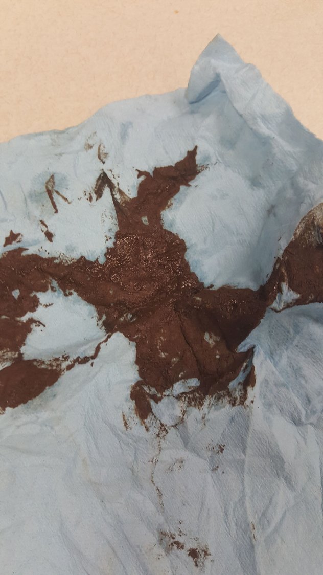

Drove the truck to work today. While showing it off to a coworker, I pulled the radiator cap to check the water level. I found a layer of brown sludge.
I just installed this radiator earlier this year. Do I just need to flush the system?

Yes, you need to get that crap out of there. Chances are the crud is in the block. Was it a new radiator, clean radiator when installed?

It is a re-cored stock radiator. I had an aluminum rad that i ran for a year prior to the switch. Im surprised I didnt see any sludge when I drained the system before the swap.

What type of fluid are you using? I know there are some out there that have caused issues similar to this.

Just generic green antifreeze. Autozone brand, I think.

Looks like oil in the coolant...time to check the system for leaks. What does the engine oil look like? Been using oil lately?

It's always used a little oil. Last I checked the engine oil just looked dirty. I haven't noticed any water in it.

So this is a stock engine? 6 or V8? It's very hard to get oil in the water on a flathead, much more common for water to get in the oil.

Stock flathead v8

Hopefully just old antifreeze from the block or heater core. Dexcool was notorious for this when it came out around 1995, it would turn to mud if air got to it, but even regular antifreeze gets ugly and leaves sediment if it isn't changed once in awhile. I would buy a kit to hook up a garden hose to the system and flush it all out with the engine running.

I have very good success with the Prestone Flush 'n Fill kits. Just follow the directions.
