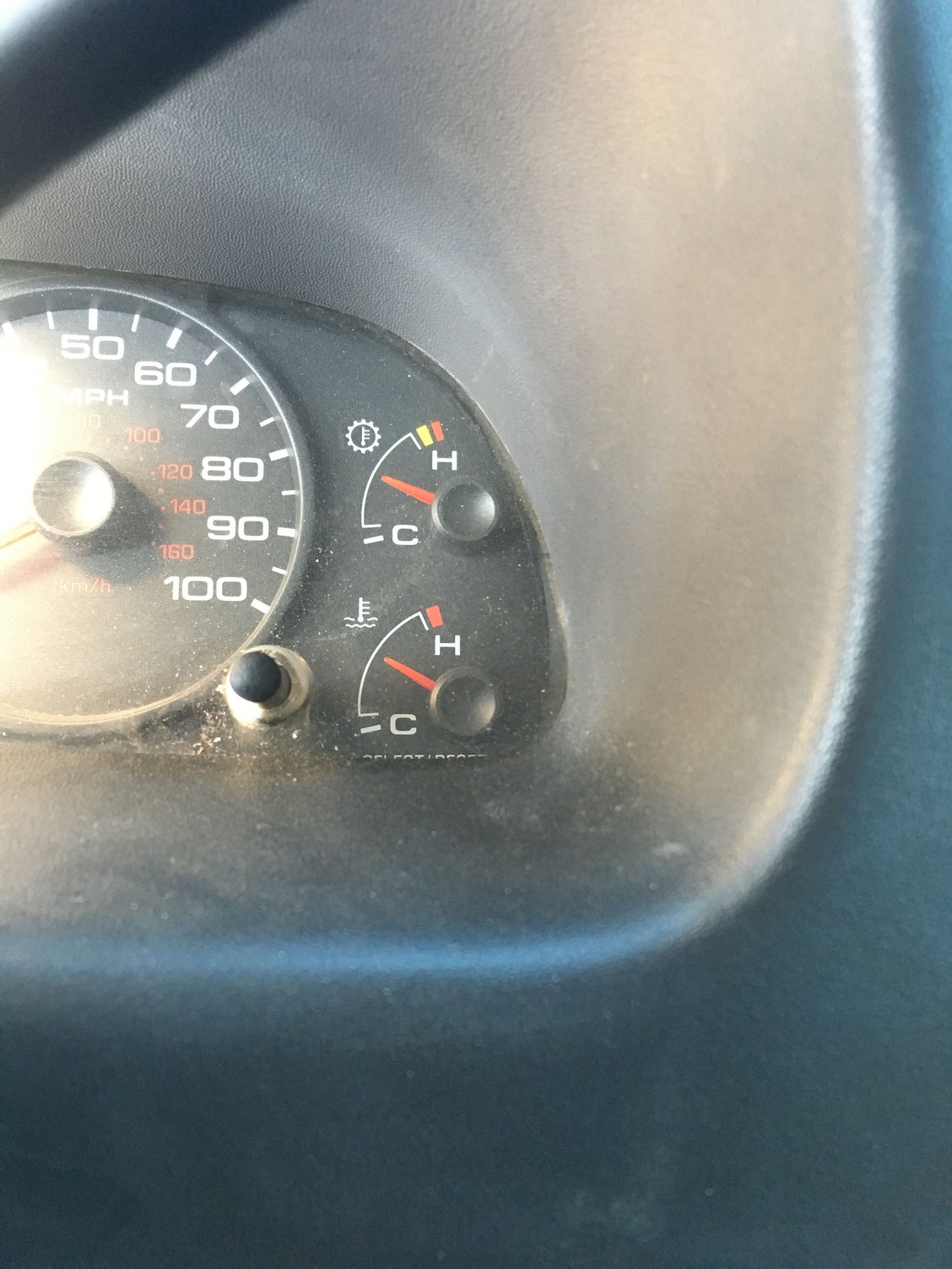

So I just bought a 6.0 with 140xxx, studded, and I'm assuming aftermarket FICM due to the fact that it's a sandyish brown color, not factory from what I understand. The problems I've had so far..
Withen 5 hours of owning it the turd wanted to get warm, as soon as the fan kicked on I took notice and watched the temp gauge. I didn't let it get into the danger zone. Dealer took it in and replaced the radiator, and it got hot again, come to find out it was just the thermostat.
BUT the truck runs fine now, OTHER than sometimes when I get on it for the first time of the day and it kind of baby hiccups at top end at about 70-85 (merging on the I5 highway) the truck sits about a week at times before driven.
Yes I let the truck warm up because I have a fancy keyless start so while I'm getting ready I let it run about 30 minutes. It only does it once or twice and that's it, and then the Tranny start to act a little dumb like not knowing when to shift. I don't have a programmer just a cold air by air raid and a commifornia "test pipe" if you will.
No check engine light or anything.

And is the normal temp spot. Sometimes I swear it's a smudge higher, but I just feel it's my eyes adjusting to it because I'm staring at it so long. My 6.7 work truck looks roughly the same in needle placement comparison wise, and I put the first hard as can be 22000 on it so far

Post some more sensor readings. Like the high pressure oil and true temps from a diagnostic reader. The gauges are only approximate and not all that accurate.
