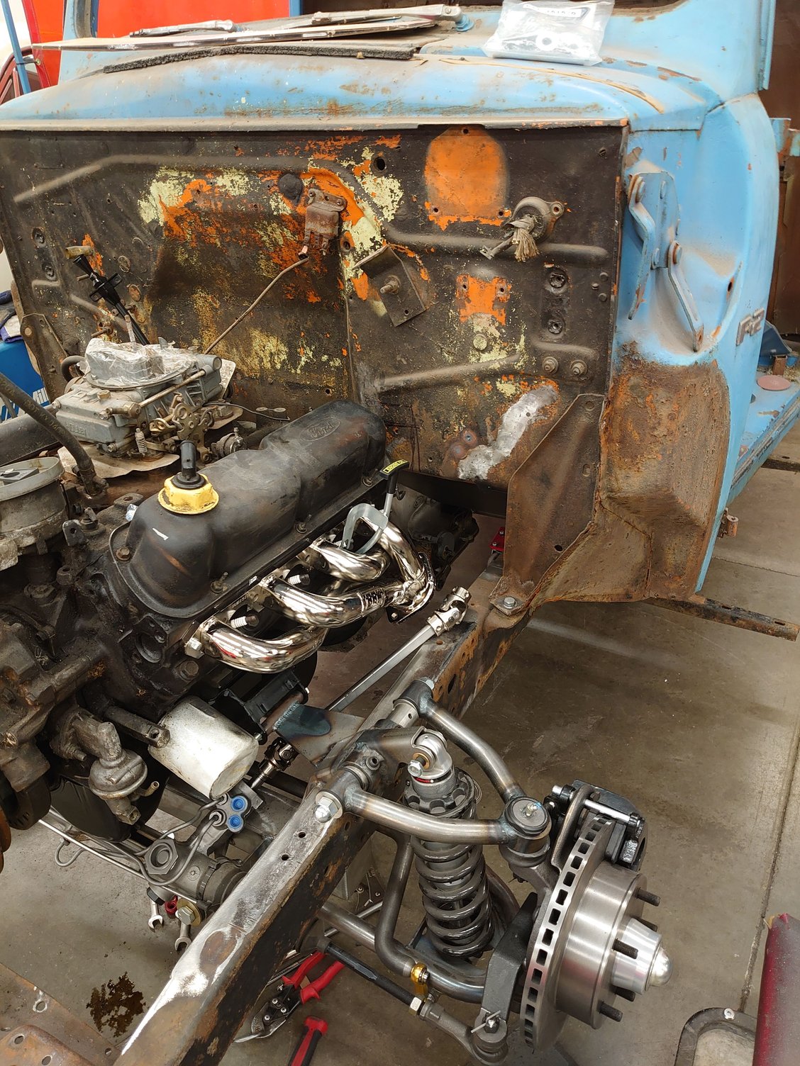

Need a different oil pan, to get the engine were it should be. First fitting issue.

I had the same issue and needed a rear sump pan..

I used the Milodon 31126 and I am real close on the front power steering rack but it fits. If I had placed the motor another 5/16ths back it would have touched. This is with front IFS and power steering rack.
