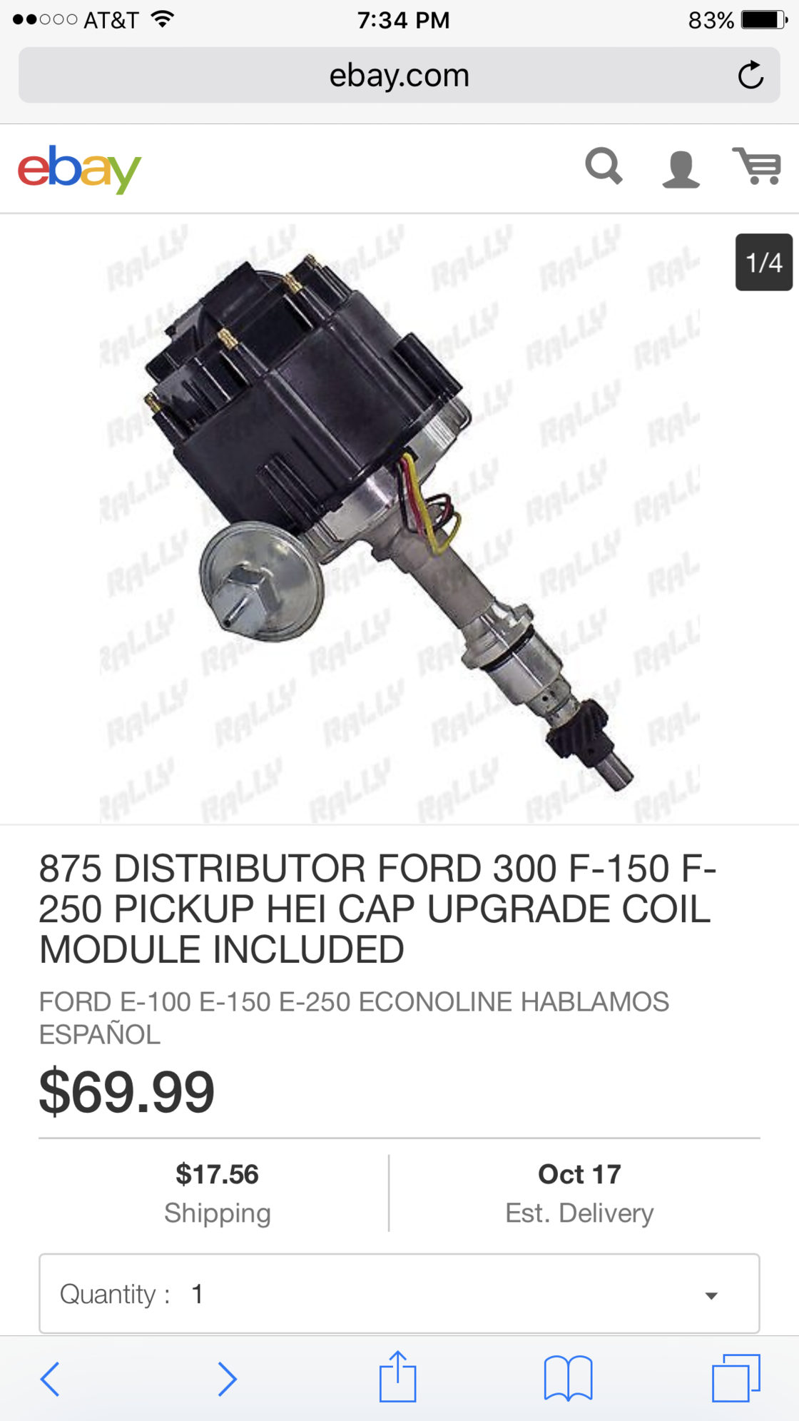

Old Oct 8, 2016 | 07:23 PM

That distributor has no vacuum advance. Advance is computer controlled.

There is your problem right there in the picture. TFI ignition.
Old Oct 8, 2016 | 07:37 PM
86f1504.9rookie's Avatar
86f1504.9rookie
Joined: Sep 2016
Posts: 27
So I need this one on eBay?
Old Oct 8, 2016 | 07:41 PM
Franklin2's Avatar
Franklin2
Joined: Jan 2001
Posts: 56,997
Likes: 2,743
From: Virginia
Yep, that would work. It has all the goodies in it to advance the timing as the rpm increases, and also vary the timing with engine load with the vacuum advance connection.
I seem to remember your electronic carb does not have a ported vacuum port like you need for the dist. But you could do it in stages, new dist with electronic carb, and then change the carb out later. That would be a large improvement over what you have now.

Old Oct 8, 2016 | 07:51 PM
86f1504.9rookie
Joined: Sep 2016
Posts: 27
I believe I do have a vac port on the carb but unsure and it's dark. I have learned a lot tonight or so I think I have and will know more tomorrow. What kind of carb would I need to eventually get as Dave mentioned above?
