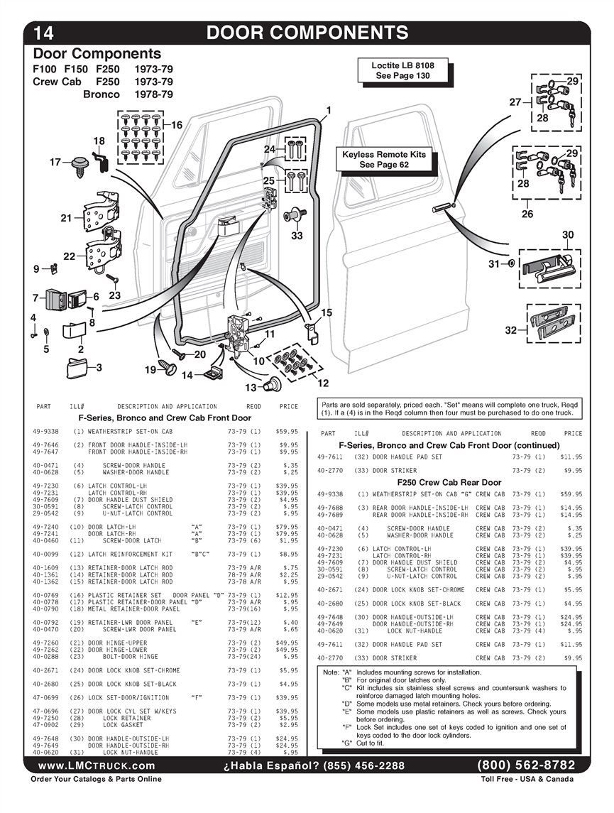

Is it possible to replace the female part of the door striker? I've got one that's stripped out.

Are you talking about the door latch assembly?

Strike item 33
Latch item 10

I'm talking about the part that the striker (33) threads into
