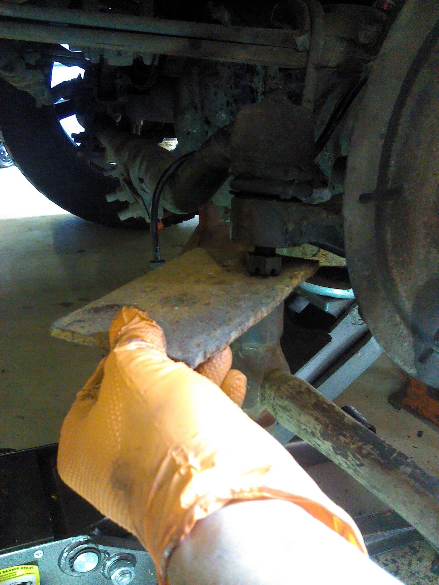

A hearty thanks to Glowplugger for bringing this topic up
Here's a tip to remove the tierod end from its socket.
Loosen the lower nut and back it off until it is flush with the end of the bolt. Hold a piece of stiff metal flat against the end and whack the metal sharply with a hammer. The nut will keep it from flying out, smacking the ground, spilling your beer...
Mine popped right out. This was on my Excursion 4wd front drivers side a few weeks back.
