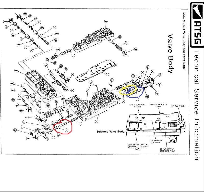

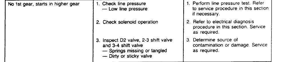

Mark i believe the trans without power doesn't leave the trans in high gear all the time but,rather when in the D position.im fairly sure,without power to the solenoids,when you shift manually into the 1 and 2 positions,you'll have (or should have,rather) 2nd gear.
here are some other issues that can cause high gear starts.
here iv circled the d2 valve in red.
2-3 shift valve in blue.
3-4 shift valve in yellow.
inspect the springs and ensure the valves slide easily.transgo has nice reprogramming kits to help avoid issues like these.since your gunna be in there anyway.....

Hi guys, thank you for your replies and the scheme.
The solenoid has just been replaced (as the tq converter)
It shifts fine through all the gears.
