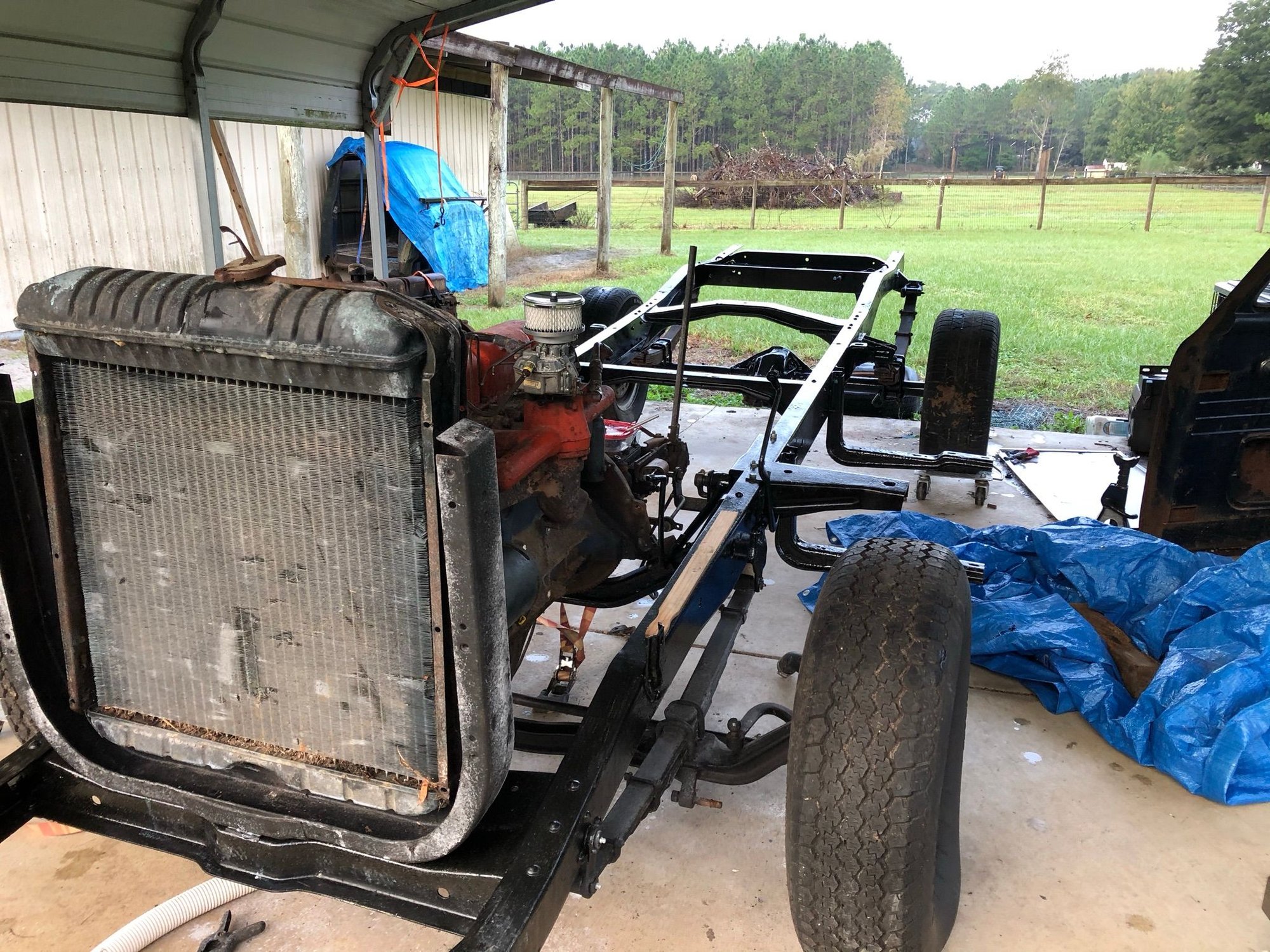

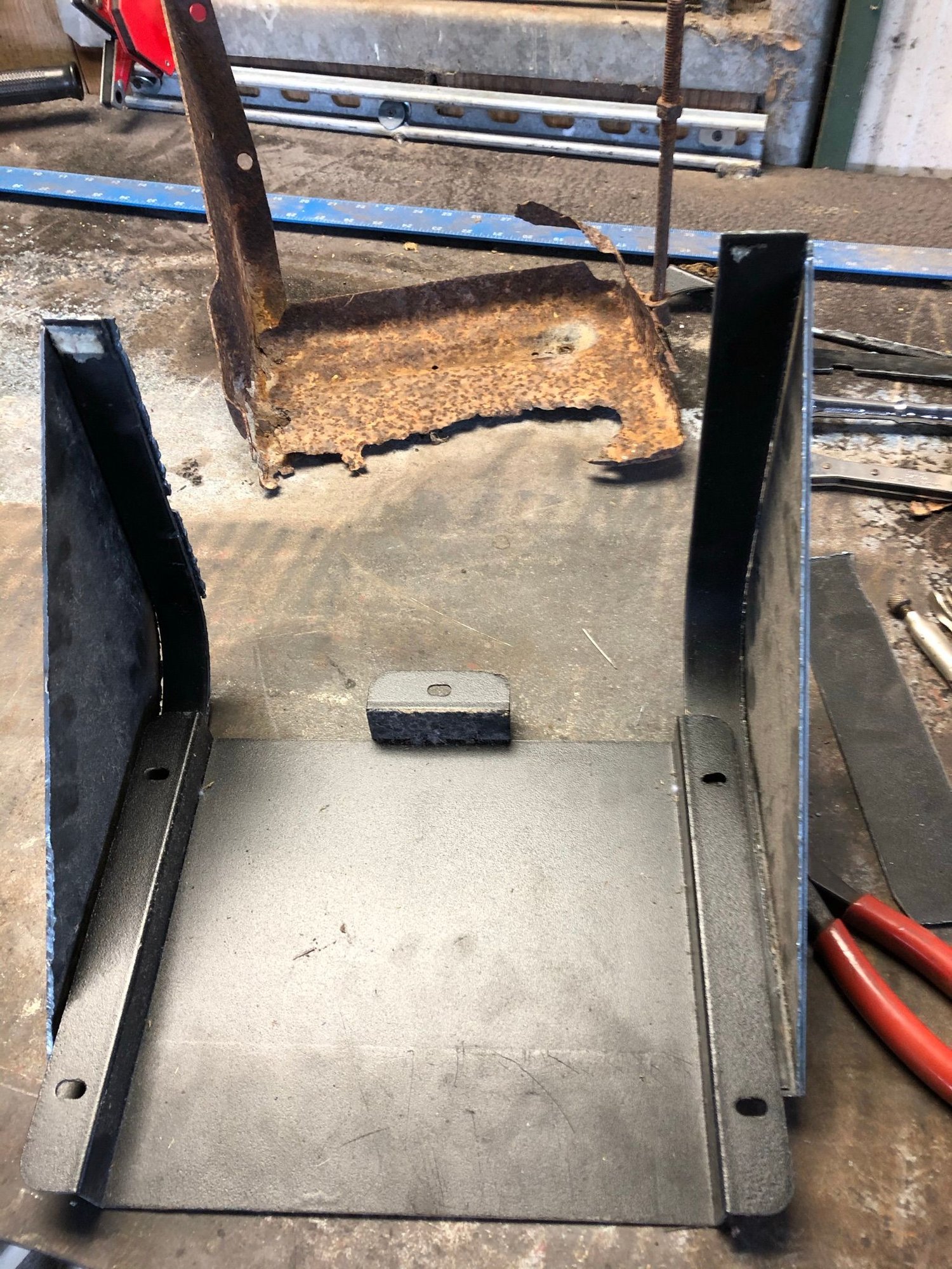

Guess I suck at updating the forums, been a bit since my last update. Frame and rear end all cleaned and painted, engine installed for mock up, new engine mount fabricated, radiator support and rad installed.
Got a new toy in the form of a plasma cutter, that thing makes cutting metal actually fun. Took about 5 mins to fabricate a rough battery box.
Getting close to starting on the cab, few more odds and ends on the frame. Find a 28 spline 1310 series slip yoke and some new 1310 series u joints, some brakes and it could at least yard drive.

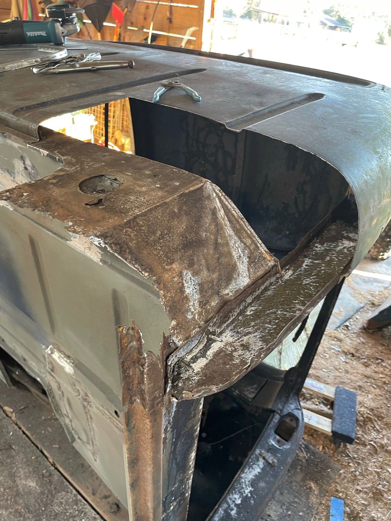

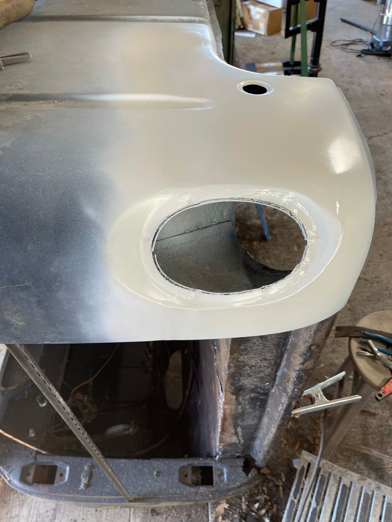

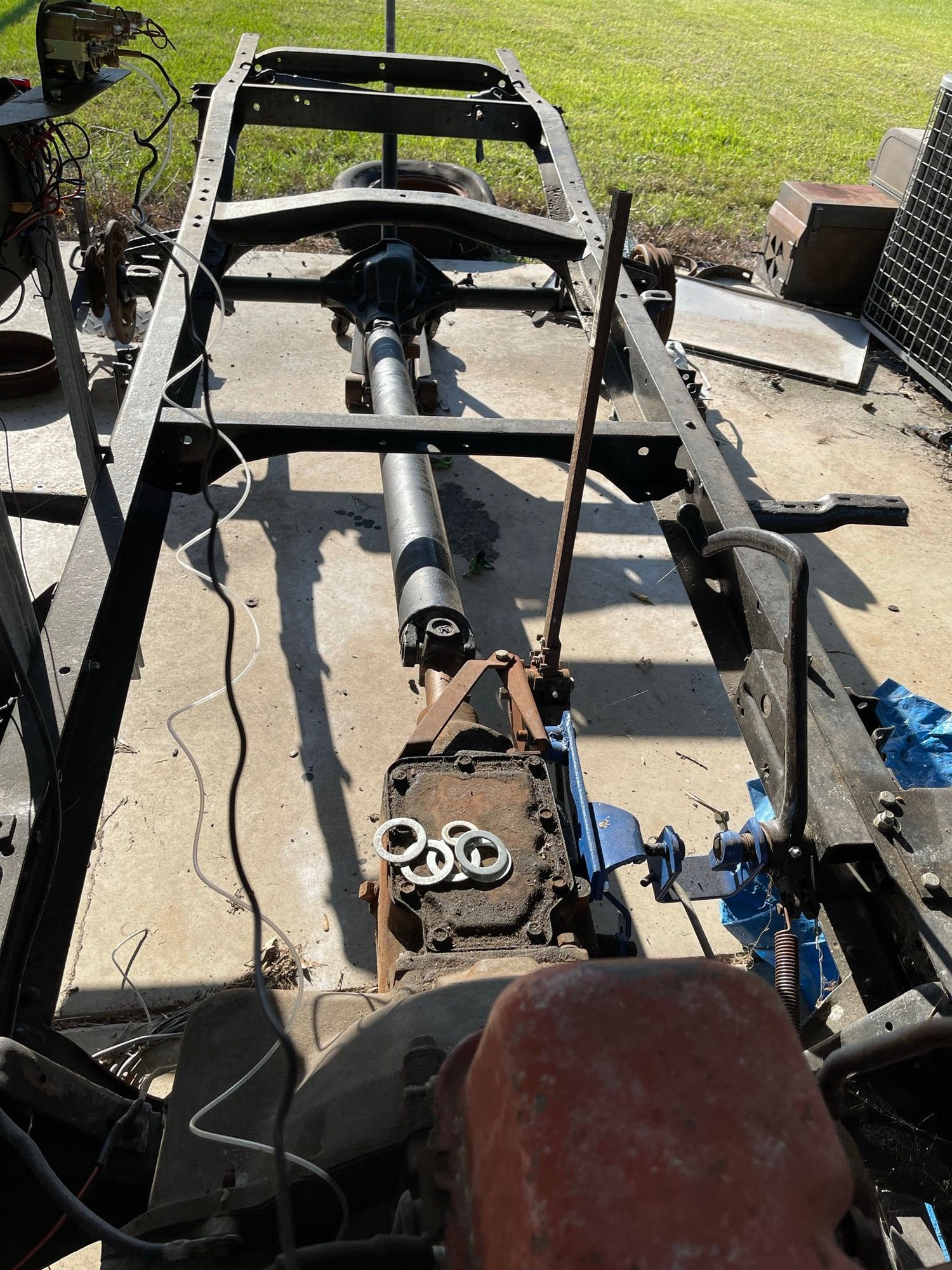

Another year, made a little more progress.
Drive shaft made and installed
New master cylinder, brake line, wheel cylinders, springs and shoes all around.
Carb rebuild kit from Mikes Carburetor.
Now she runs and can stop and I have a big go cart. Helped find all the oil and water leaks as well.
On to the cab, welds suck but it works.
Still got a few more places to weld up and I can bedline and flip it over to do the cab corners and some other things.

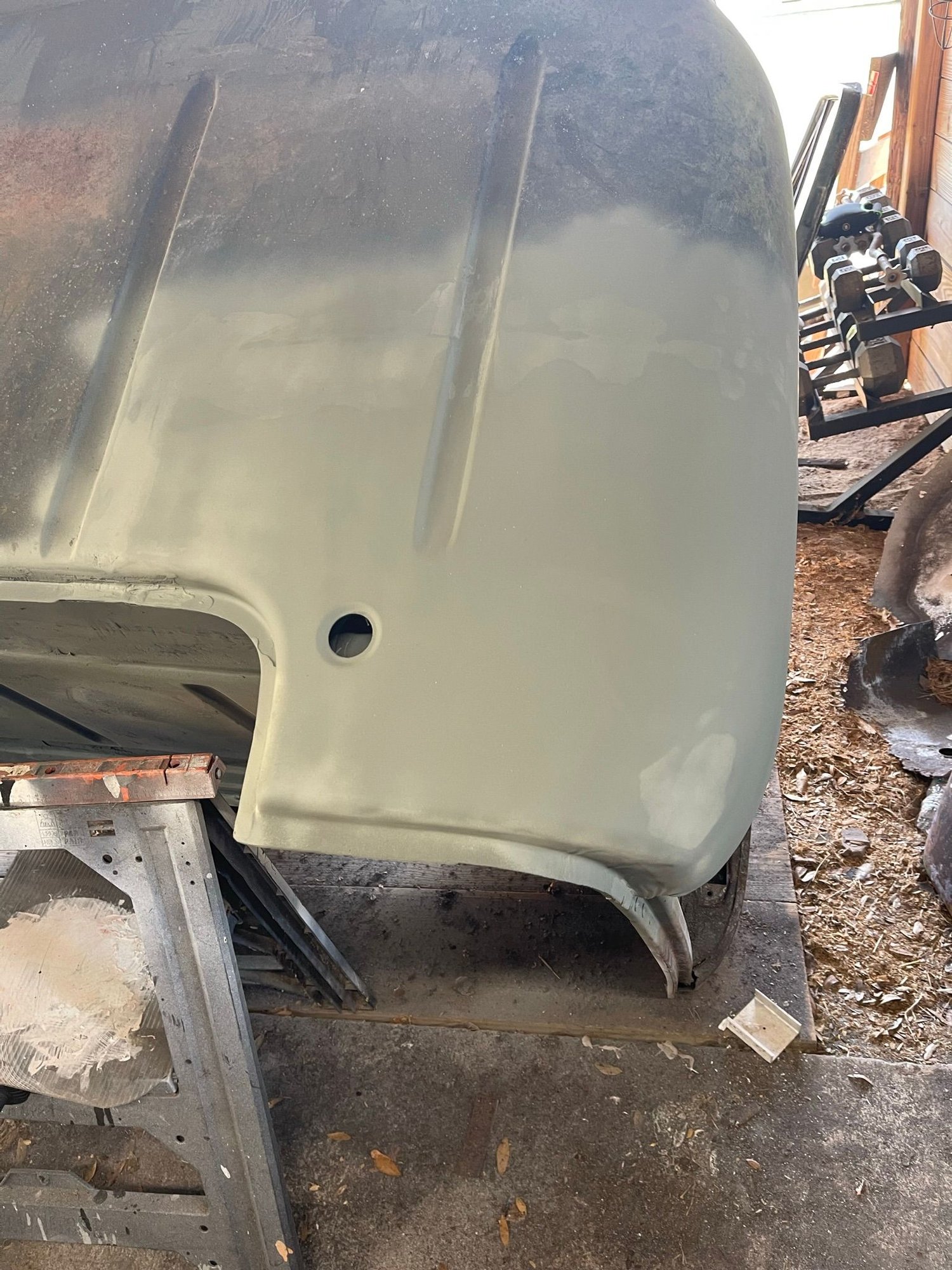

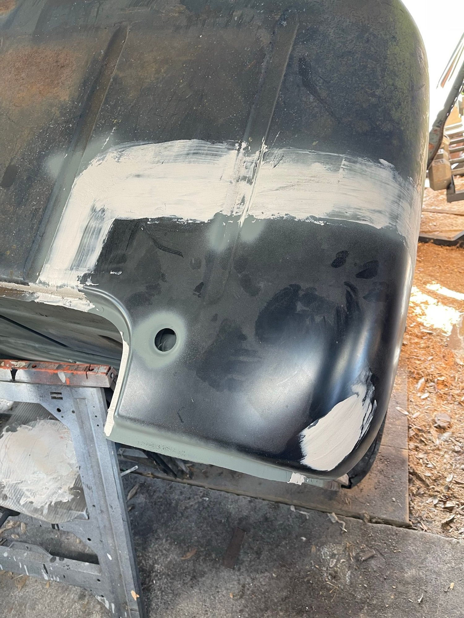

Little more progress made on the cab corners
