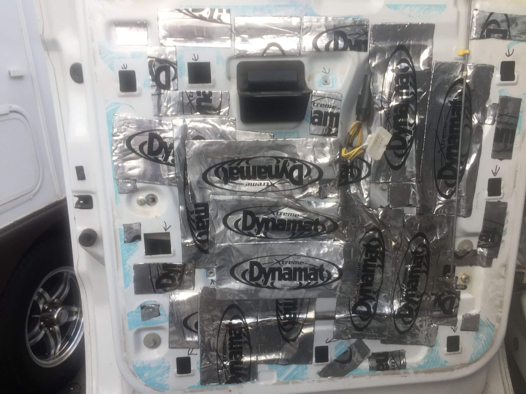

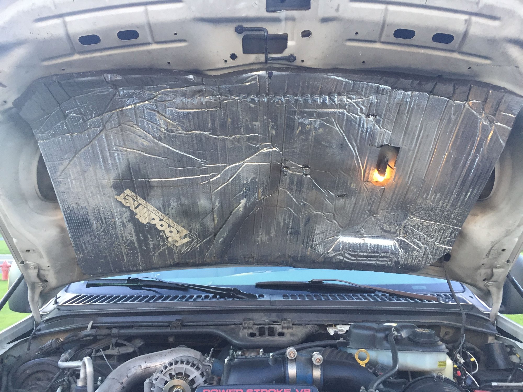

Pics of my Dynamat lining.
[IMG]https://cimg5.ibsrv.net/gimg/www.ford-trucks.com-vbulletin/2000x1504/80-img_4292_db269d55961d40e82e24d23b05d8678472e0132c. jpg[/IMG

Thx Fordblueheart on the pic fix!
I did not take any DB readings before & after as I was in a rush to finish before 2 week family vacation this past July (MN to New Mexico & back 3,400m). What I can tell you is the hood quieted down the engine noise I would say by 10-15% (not a lot but I think it was worth it). The 4 doors + rear of truck cut down road noise by at least 30% if not more. I can run my truck tomorrow at 60 mph & take a iPhone DB reading but would need to wait until Monday to use a pro-grade DB meter from work. I replaced the front speakers with Alpines & then a new Pioneer AVH-5800BHS touch screen deck. I hope to add more sound upgrades in the future. I have already purchased a small Alpine 4x50 watt amp & plan to get 6.5" Alpines separates for front & move 5x7 Alpines to the rear & then add 2-6" Bazooka powered subs in back. I can't use 8" without building a custom bracket to move rear seats forward roughly 1.5". Oh well.
