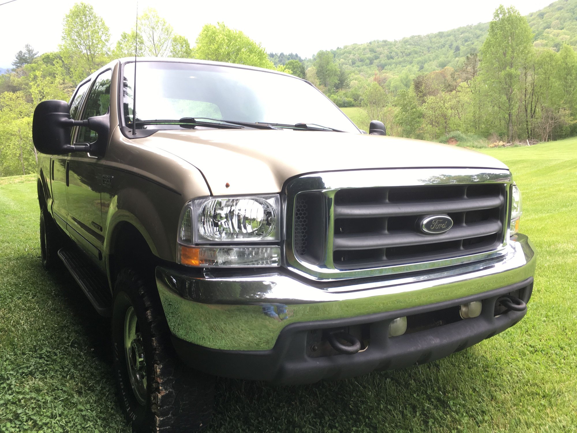

The ‘02-04 are waaaaaaaaay better than foggy ‘’99-01 lenses.
Drop in LED’s mostly SUCK for actually putting light down the road. They scatter the light annoying other drivers and sacrificing your safety by not projecting as far as a good halogen in a good lens.
The best light is ‘02-04 lenses with a relay harness and HELLA or Optilux 100/80 watt bulbs. This is about a $200 upgrade that will make you smile every time you drive after dark.
www.rallylights.com builds a nice relay harness.

No, it is straight up rude to run ‘most’ drop in LED bulbs. They are *more* annoying than just being below the cutoff line of DOT spec bulbs and lenses. They also fail to project light as far down the road.
I strongly encourage you not to be one of those *******s and have provided choices that provide more usable light for you without being a dick to everyone else on the road.
You can find lenses like I posted above for under $50/pair - this with the bulbs you have now is a significant improvement. Add Silverstars or relay harness and higher wattage bulbs for all the light you need - without being an *******.
