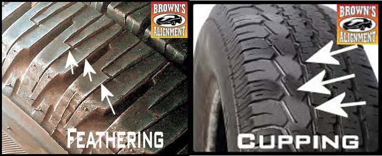

Feathering
Feathering is a condition when the edge of each tread rib develops a slightly rounded edge on one side and a sharp edge on the other. By running your hand over the tire, you can usually feel the sharper edges before you'll be able to see them. The most common cause of feathering is incorrect toe-in setting, which can be cured by having It set correctly. Occasionally toe-in will be set correctly and this wear pattern still occurs. This is usually due to deteriorated bushings in the front suspension, causing the wheel alignment to shift as the car moves down the road.

That is called "Cupping" usually caused for weak suspension. Alignment can cause this sometimes. However, with heavy knobby tires like that, the shocks have a hard time keeping them planted. Most shocks usually have a "multistage valve" installed. The 1st valve is constantly opening and closing and is usually the 1st to go out. It allows the tire to hop rapidly as you're driving down the road, causing the high & low tread wear.

Cupped or scalloped dips appearing around the surface of the tire tread wear could indicate loose, worn or bent suspension parts. Worn shock absorbers or unbalanced tires can also cause cupping, but the cupping would typically be more indicative of a concentric pattern. Shocks and struts are the most likely culprit because they provide damping force to control tire movement. When the tires move excessively, the scalloped pattern can appear. A lack of rotation can cause this condition.

Well that's what I was thinking but it does look like cupping not feathering. So I guess I'll start with an alignment and have them check the bushings and go from there
