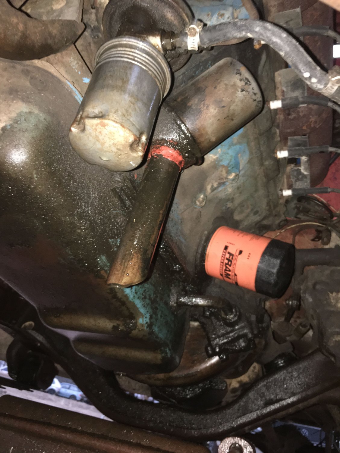

This question is for bill the NumberDummy. Good afternoon Bill a couple of years ago I picked up a 292 Y Block in pieces. Some of the nuts bolts and parts are missing. Looking at the left side of the block of a two bolt opening down low on the block. referencing the illustrated parts books I identified the opening as one used by the late 50's emission system (road draft tube). Looking further in the book they show the one used in 1962 and it looks like the one I currently lave on the manifold and valley cover. I know they blocked of the opening when they did the change, but can not find the part number and gasket number. Can you tell me what the numbers are please?

No PCV emission system until 1961. 1961/64 292: The road draft tube was not used when PCV was present.
Road draft tube located on the left side of the engine block thru 1959, located at the rear of the engine beginning in 1960 (I cannot find a pic of it).
You're asking for the parts that blocked off the road draft tube used thru 1959, but are there such parts? I don't see anything in the engine pic. I'm now looking thru the text.
Edit: I don't see anything, it's probable that when Ford changed the position of the road draft tube, they changed the engine block.
Upper pic: Road draft tube used thru 1959.
Lower pic 1961/63 with PCV .. The 6A665 adapter replaced the road draft tube.
