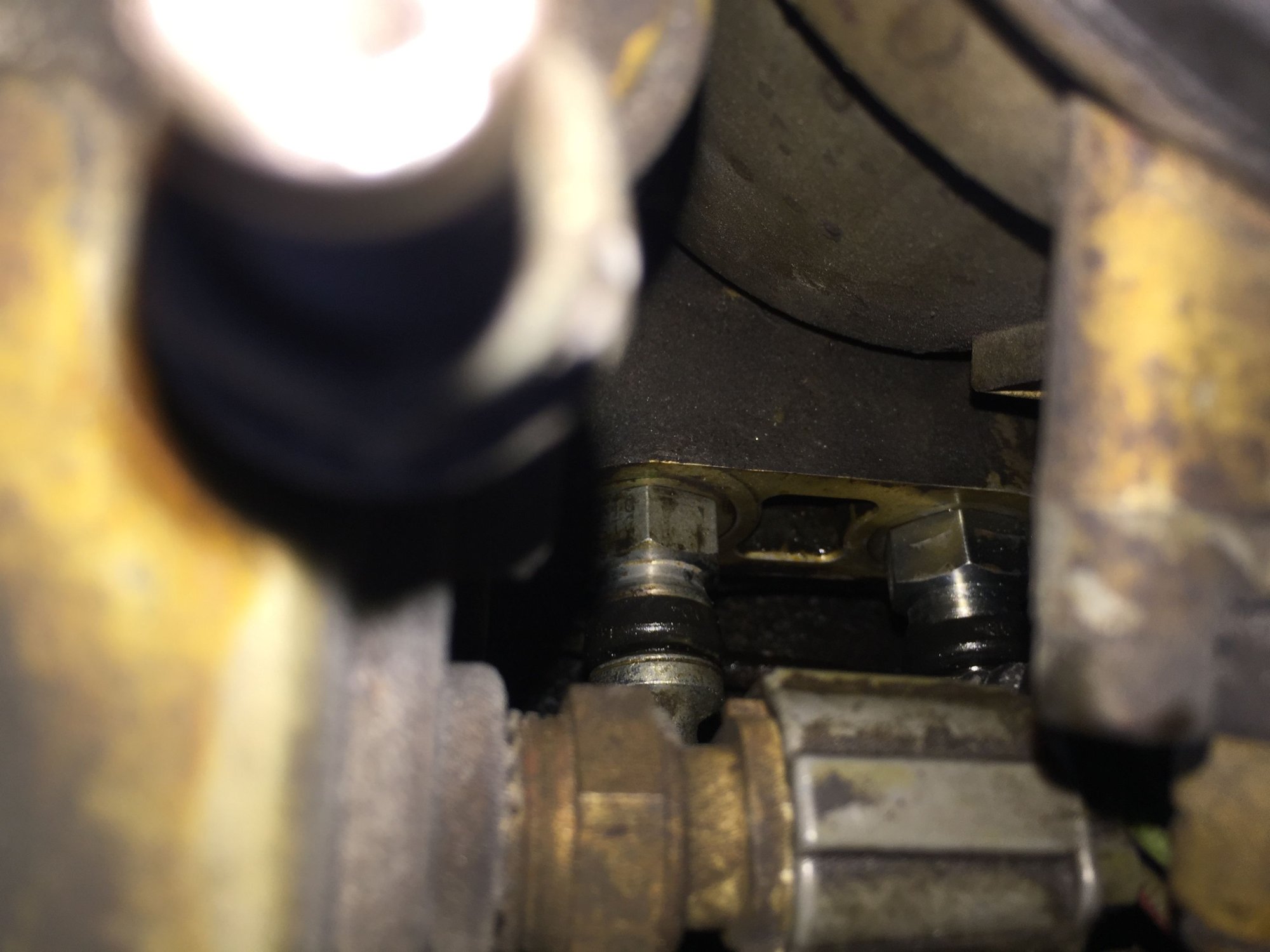

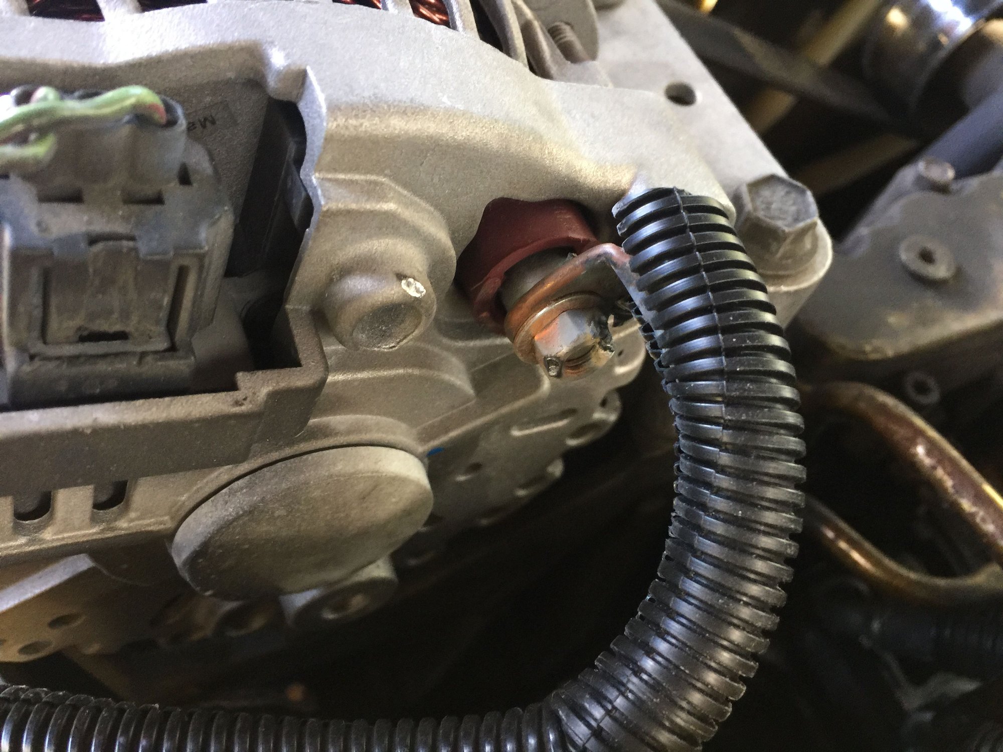

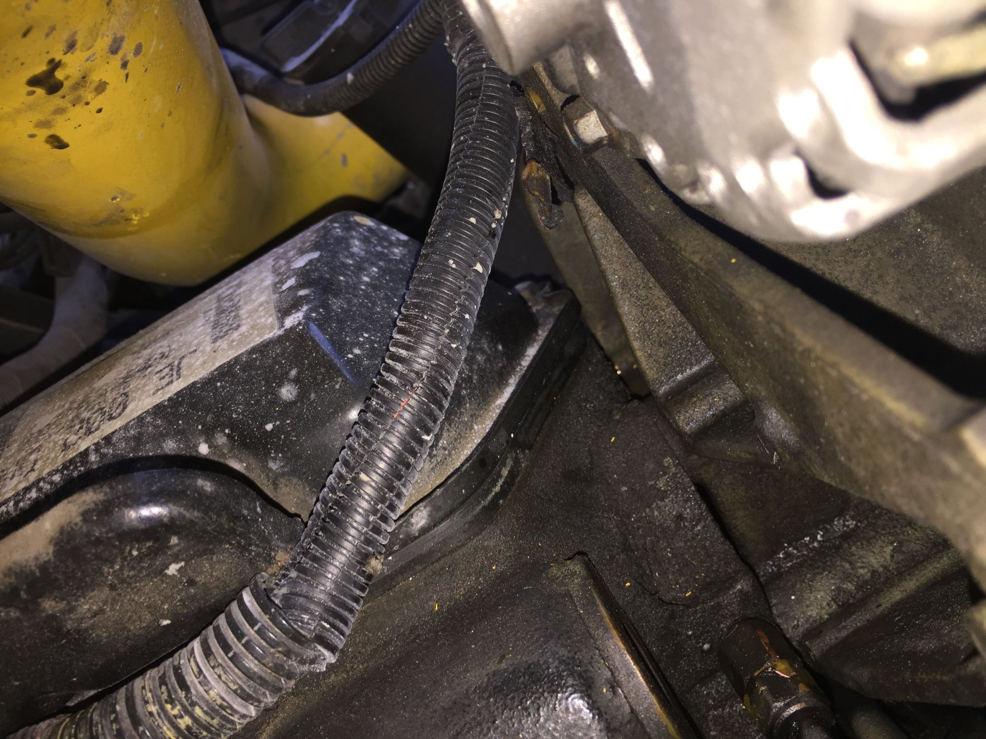

This is all I could find for burn marks. Have a couple spots on the alternator. Then the small piece of loom I replaced. And the hole between the HPOP fittings is where the screwdriver was.

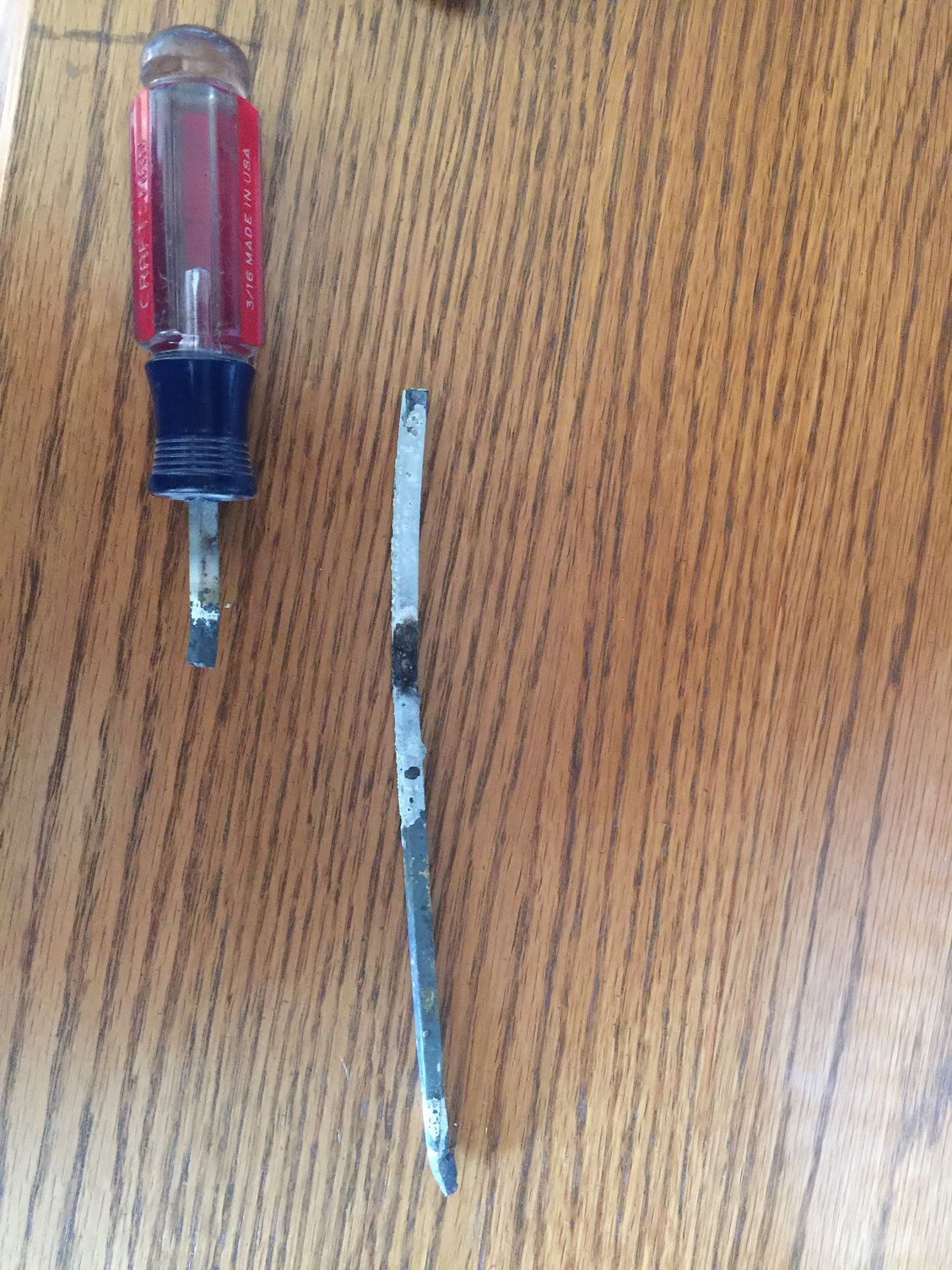

Here's what's left of the screwdriver. Half of me wants to see if Craftman would exchange it

"see if Craftsman would exchange it"
Great pics
