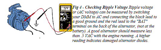

It's called a Ripple Test. Here's a simplified pic.

Thank you sir. I appreciate the pic. I will do that in a few min.

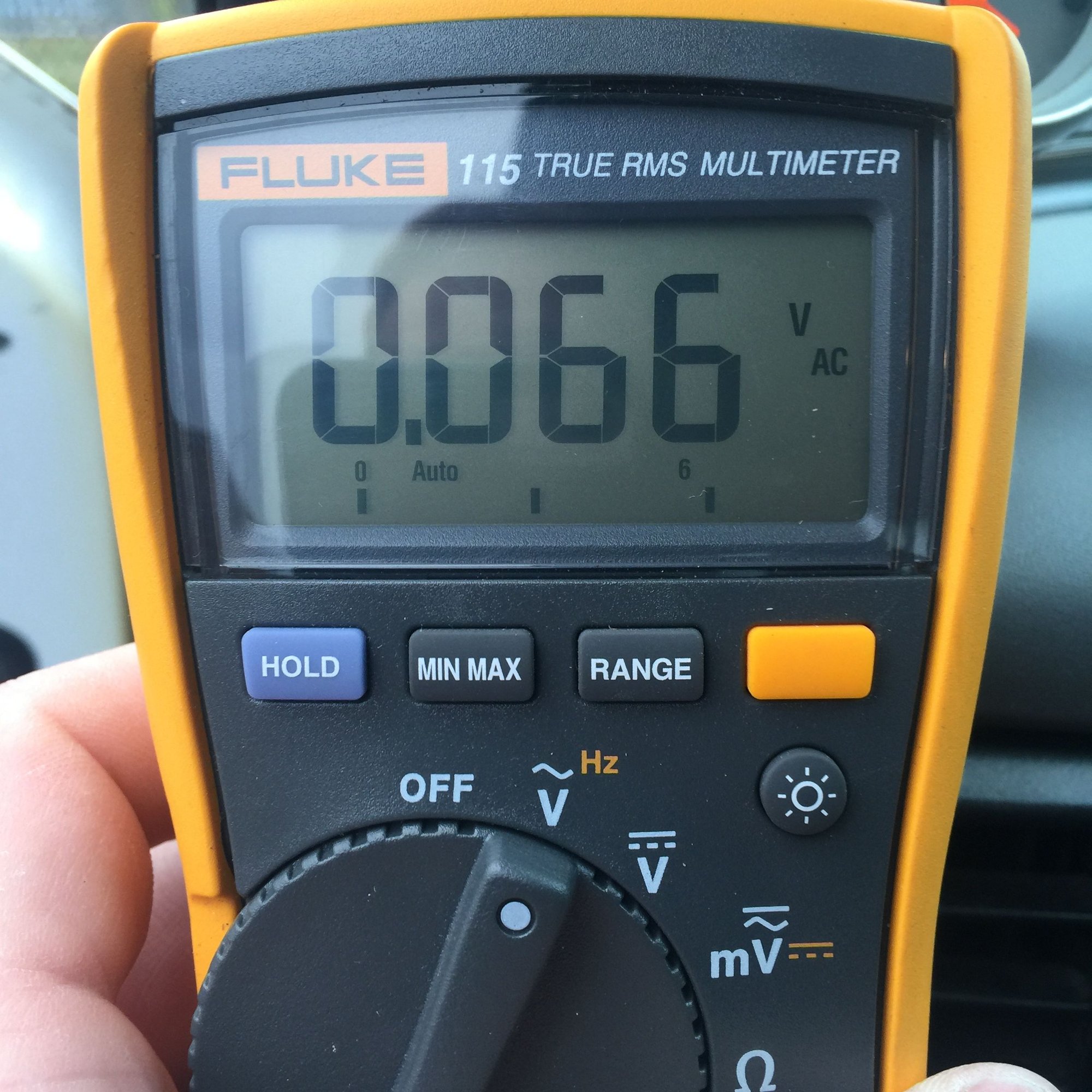

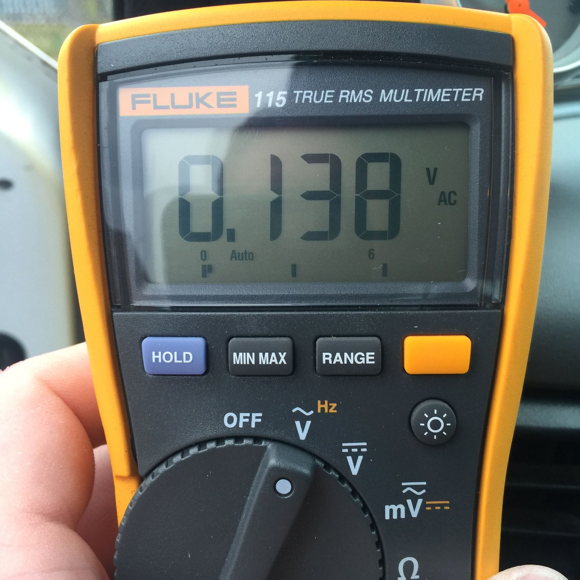

Okay, good. If you can, have someone rev it up to about 2k rpms while you measure, too. Just to be sure

Alright. At idle is first. Then 2,000 rpm.

Looks like you found a problem
As your rpms increase, so does the AC/interference, which can cause all kinds of things to act strangely.
I'd replace the alternator. The findings coincide with the mode of injury, so that increases the likelihood that this is the "main" problem

Am I missing something? Test you sent me said below .5V. Am I brain dead or even at 2,000rpm reading am I still below that?
Well, looks like YOU aren't the one who is apparently brain dead this eve
I glanced at your pics and thought the scale was showing .5 and 1.3
Well, that is NOT the case apparently. Glad you questioned it, sorry.
