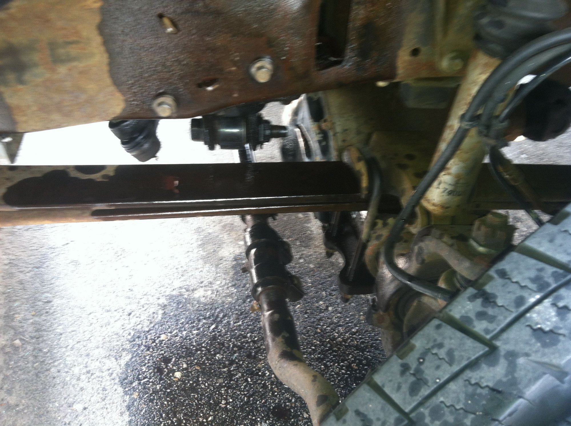

Before I find the problem, anyone want to take a guess as to what popped?
Was making a U-turn, and out of no where, had no brakes and no steering.. Not a fun situation to be in

Yeah... your high-pressure hose on the PS pump blew - common at this age. I got a piece of this - easy fix.

My luck, it's the 160.00 line that went. Replaced the pump a few years back, and dropped that white washer seal. Find it inside the cool, lol. Took an hr to fish it out, haha

Found the line. The one off the side of pump, to the firewall fitting...now, anybody oppose having a line made, using jic fittings off pump and firewall fittings, out just go get another line?

Thee entire line blew out the fitting, leaving just the "bolt" in the pump.
removing the intake, ic tube, battery and tray, it was plug n play. However, must've walked a mile between driver door and front of hood, refilling the p/s unit..
