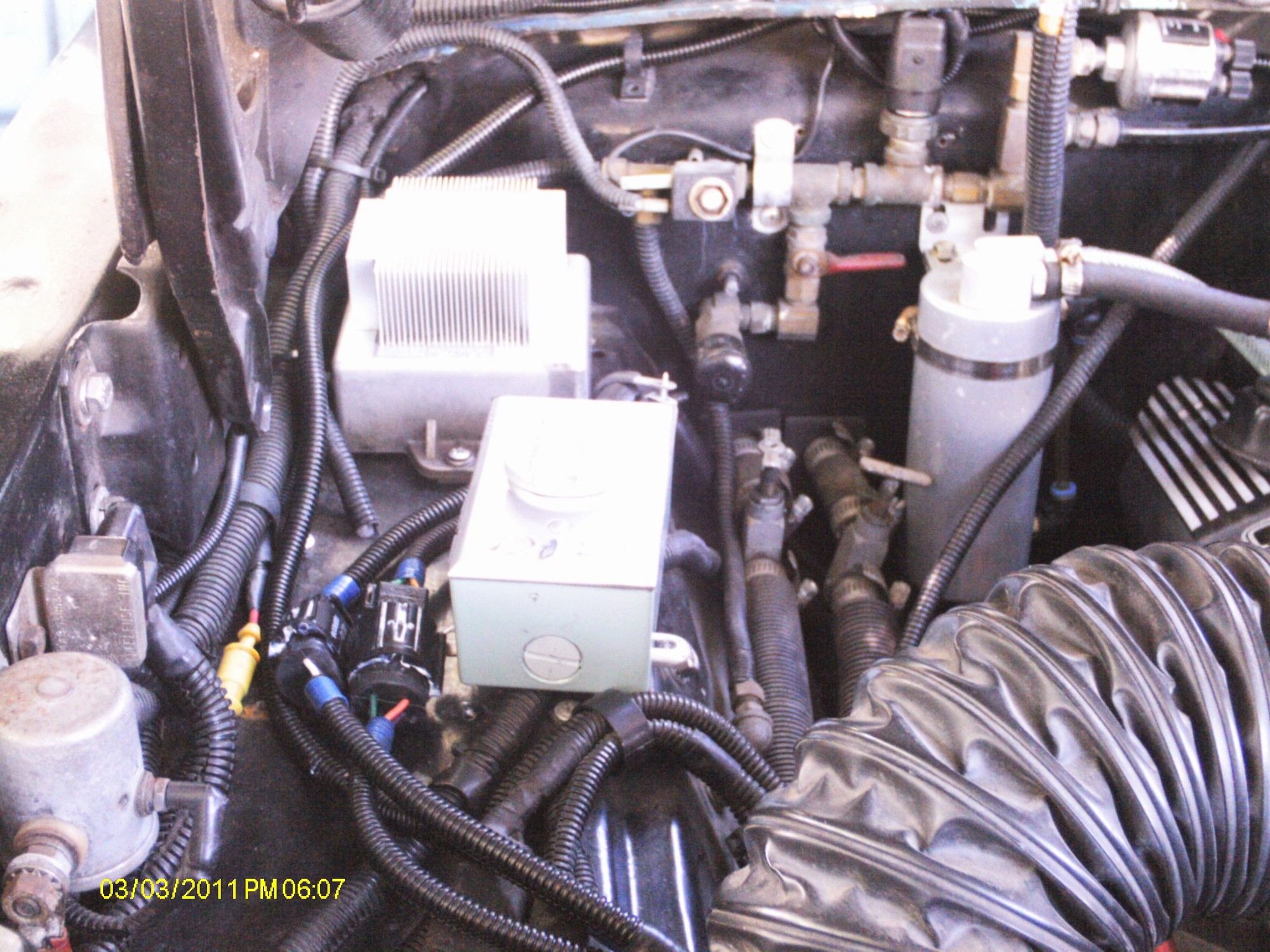

Yeah I've got one 2000watt one weather box 115volt here under hood and one in the bed. Unit mounted under the bed the picture not very good tho.

I never run the motor while using mine. It has a built in safe starting voltage monitor that shuts off the unit and starts beeping sound.
Picture in the bed outlet with a on switch an a light in installed in it when on.
And when first installing unit checking cord length

I'm running two #0000 cables to the back from my deep cycle battery with a 150amp braker, then a 10ga. extension cord up to the front ac box under the hood.
My tail gate has become my work bench most of the time now having the invert handy at all time when in need.
