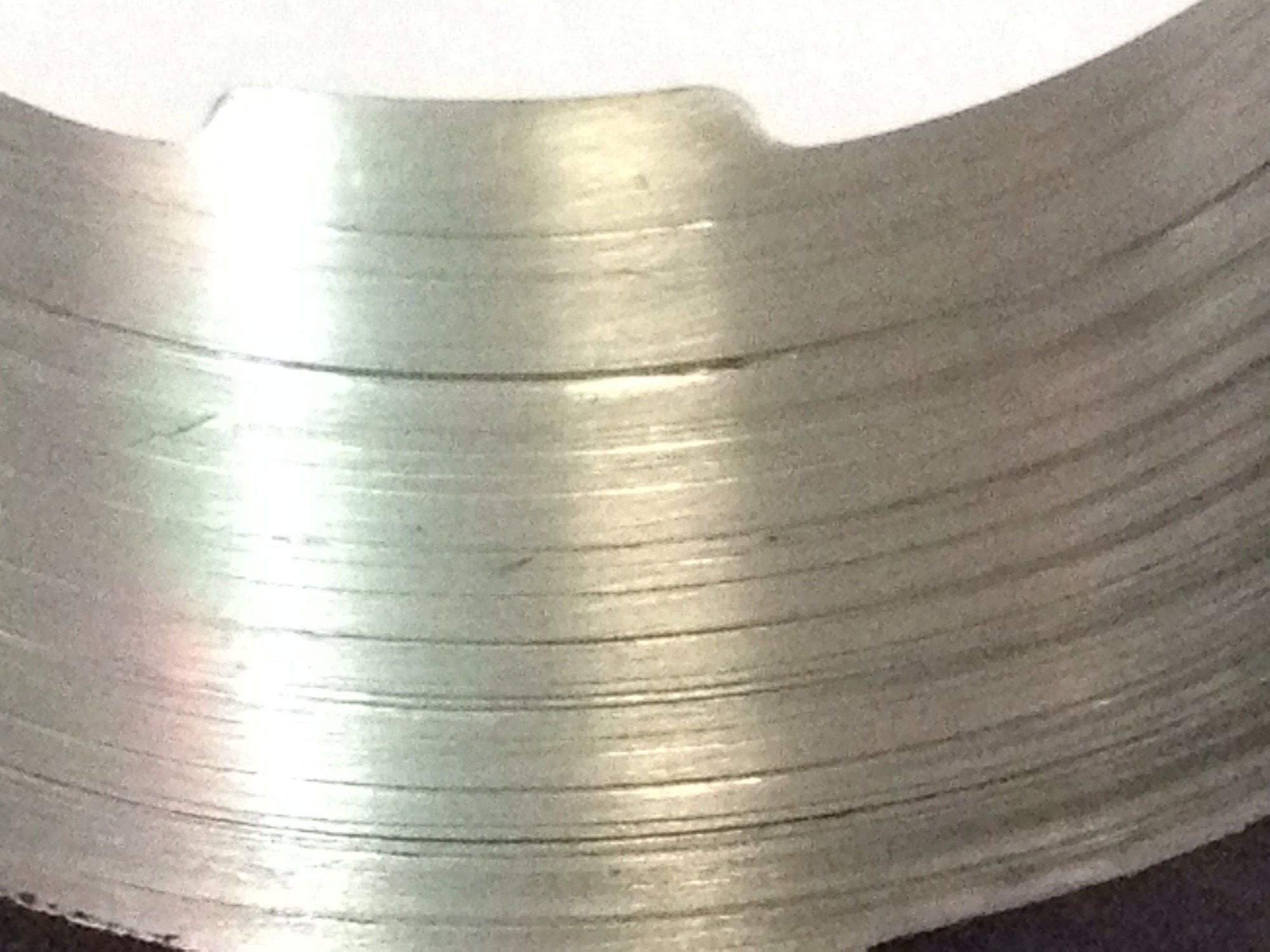

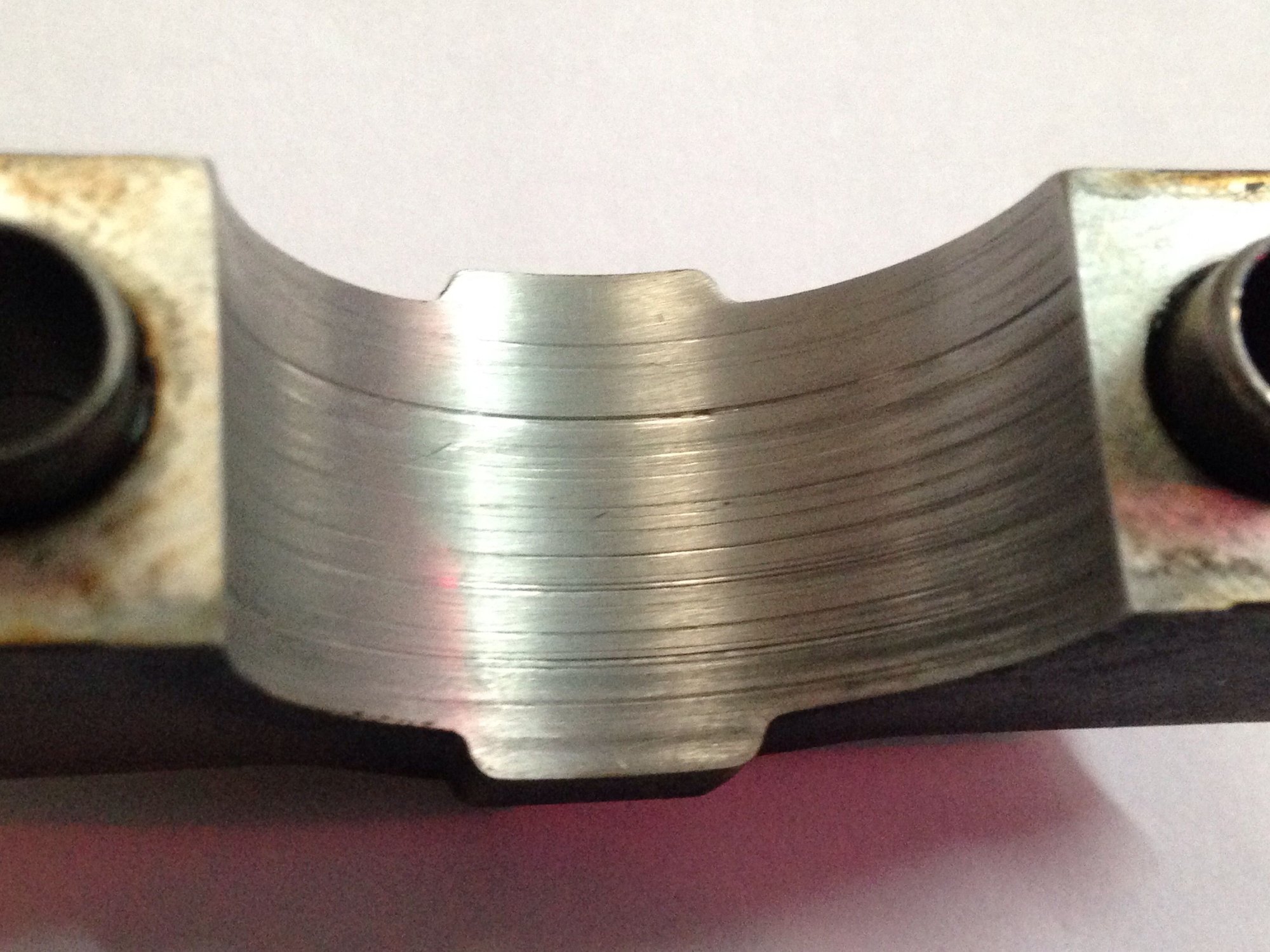

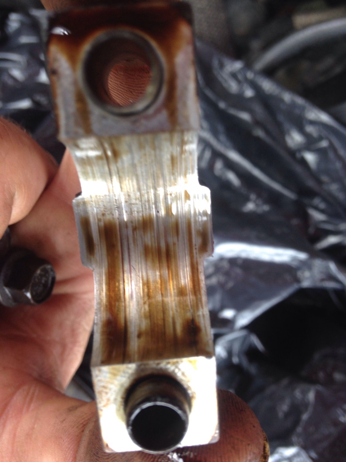

Originally Posted by m-chan68
Sorry I'm a little late to the party, but I'd be more concerned about where all the rubbed off fragments of metal ended, and how much damage (if any) it did at this point from those pictures. If you're going to inspect crank bearings, it sure wouldn't hurt to inspect cam bearings on the top end as well. The last thing you want, is to throw in new phasers and whatnot, only to have them fail again shortly after, due to all the residual metal filings floating around inside.
Originally Posted by lwarrior1016
There aren't any cam bearings. The cams ride in the aluminum journals made into the heads.
Alright so bad news, cams and caps are scratched pretty badly, guess that means new used engine.
Havent pulled the other side yet but I'm expecting the same thing on that side.

Clean the oil off of them and rub some scotch brite on there. Then let's see what it looks like.
headed out now to pull both cams and have a better look in there but here's the cap cleaned/polished a bit.
