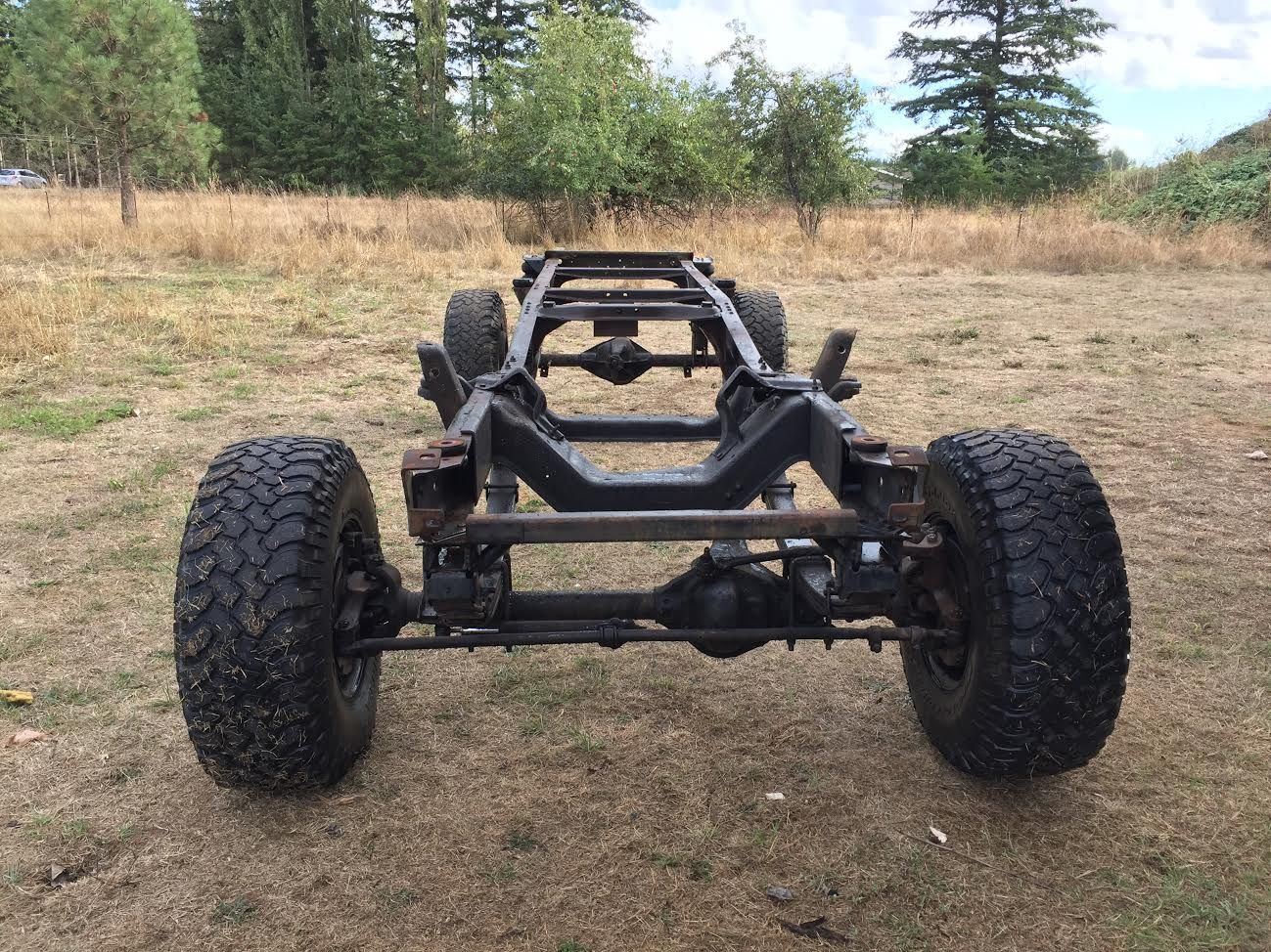

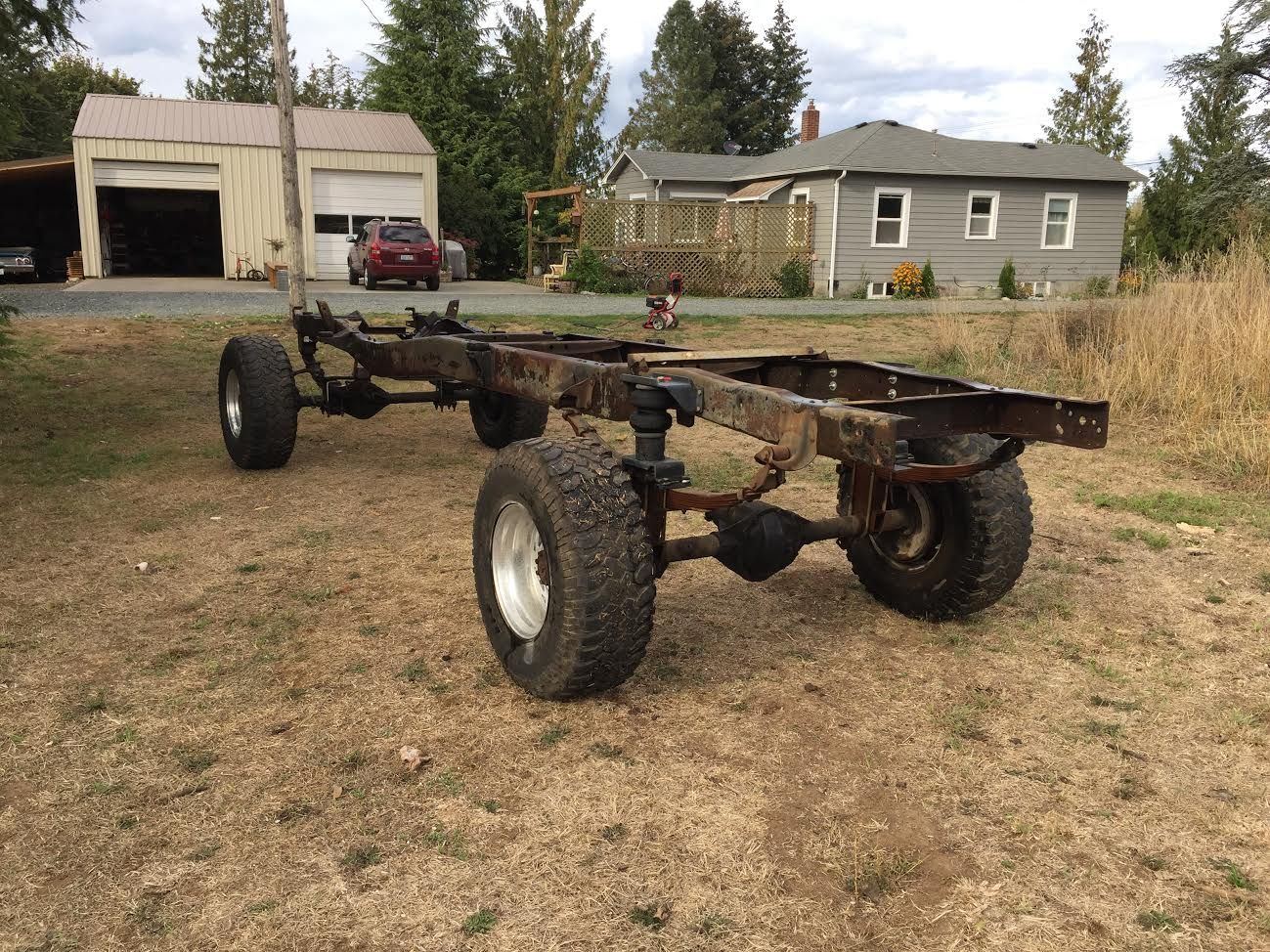

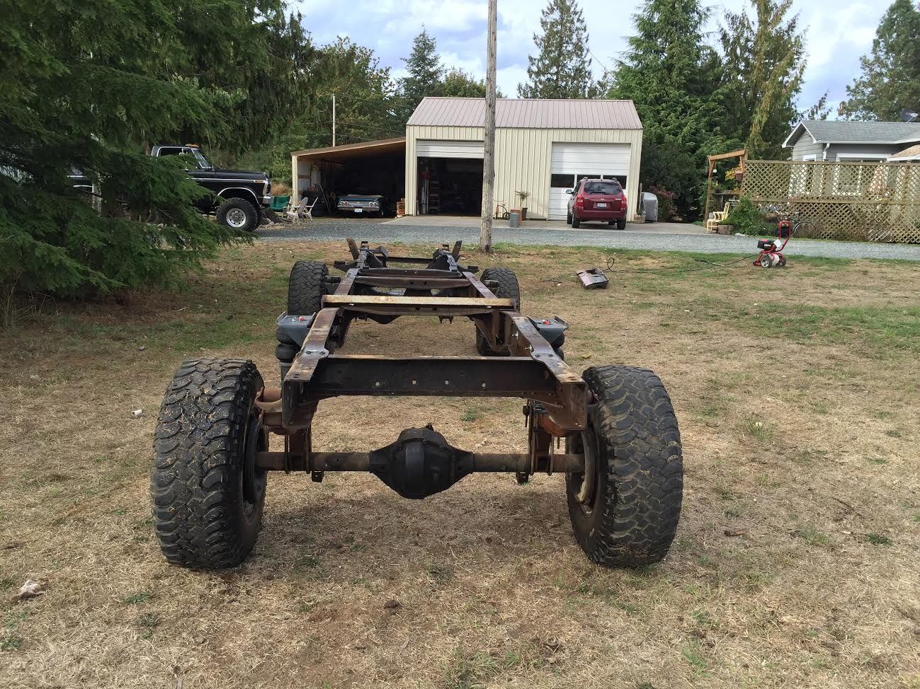

Well got my Crew cab long bed down to pretty much frame and axles, and few little things like bags and motor mounts. Now back the other way, time to build it back up.
For the Resto guys, what was your procedure on restoring the frame? Did you go all the way to bare frame?
For actually restoring the frame, seems like POR15 is the way to go? Any cheaper alternatives out there?
Let me know your step by step, what you did and what you used to restore your frame. And pictures would be nice! Thanks!

interesting rear shackle angle.
How is the clearance between front diff and 2wd crossmember? Will you notch it or not necessary?
Old Sep 14, 2016 | 01:51 PM
Coltin1992's Avatar
Coltin1992
Posts: 171
From: Bellingham, Washington
Originally Posted by mark a.
I wonder how many pounds it is good for ?
Not sure at how many pounds it's rated for. But I do know it's 100 PSI max. I also found out their firestone bags with 4 inch spacers.
What do you mean clever? Cause it's sitting outside the frame?
It was close when I pulled it off. I'm not sure how it will be when I set the ZF5, but will notch if needed.
