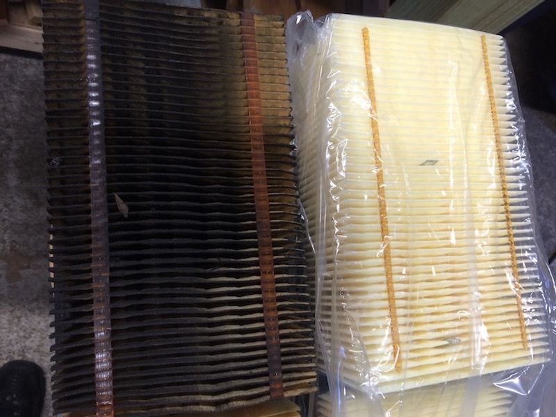

OK, so the new filter arrived today. I pulled the old one out and here is the comparison:
Here is what was in the air filter compartment after I pulled out two oak leaves:
I think it needed changing. However, the filter change indicator never moved at all.
