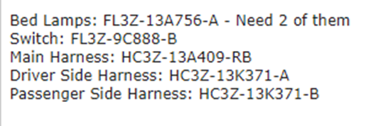

When I did my BIL's I did lots of research to find the right part numbers. Trim level, with BLIS, without BLIS, there are variables that effect what parts to order, plus an activation in FORScan. You can do it, just research your truck and parts required.
