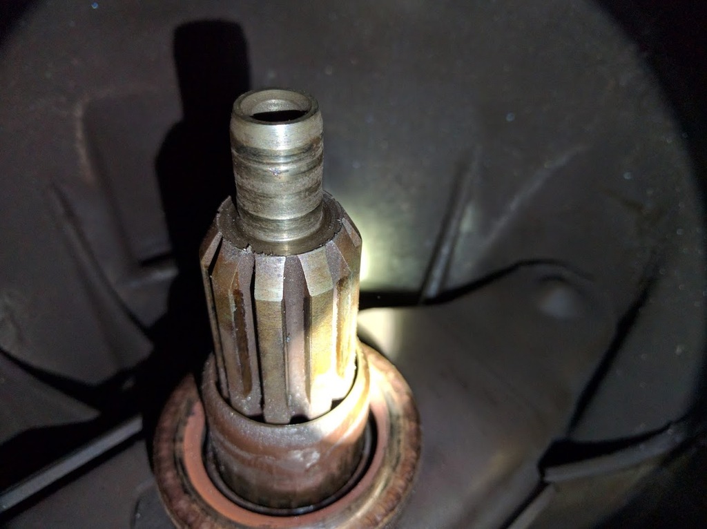

Hey everyone, once again I am looking for some insight from the great minds here. Recently My clutch completely hit the fan (Quite literally looks like it), so I ordered a southbend 400HP rated kit (with new flywheel). I planned to install a new pilot bearing and forget about the bushing that comes with the Southbend kits, but was greeted by some alarming sights once I pulled the transmission.
The main issue, is the input shaft. The pilot literally turned to dust, resulting in the shaft getting scored. I was going to order a Fitzall kit, but didn't think it would be needed as I *thought* it would be fine to throw a bronze bushing at it (Dorman 690039) as it has more surface area than a bearing would, and theoretically would ride on the non-scored areas just fine. Well, I drove the Kevlar bushing out of the flywheel and noticed that the bronze bushing was about half the thickness of the Kevlar bushing. This worried me a bit, as it would only ride on the good portion of the shaft closest to the splines, and nothing would be riding at the good portion on the end closest to the engine.
I decided to cut my losses and installed the Kevlar bushing, then installed everything into the truck (currently just sitting with the clutch on, transmission is still on the floor). I did this as I need the truck back up and running. My 91 is living on borrowed time currently (U-Joints are about to go and replacement tires need mounted). After getting a shower and getting cleaned up, I am beginning to have second thoughts about running the Kevlar due to the mixed reviews I have read about them.
Now, on to my main question for those of you that have experience with these aftermarket offerings - Which of the three options that I have below are the lesser of the evils?
1. Drive two hours to the closest Fitzall dealer and get the Fitzall kit with a needle bearing.
2. Get a second bronze bushing tomorrow at work (ordered a box of five) and run them back-to-back for coverage similar to the Kevlar's.
3. Run the Kevlar bushing for now and change it to either a roller bearing or something similar later on down the road - Be it when I replace the transmission or get the input shaft fixed (if it would be worth fixing it since the shaft is the last out and first in).
Here is what my shaft currently looks like (Tis a bit ugly...):

Can't comment on the others but mine was more worse off then yours was, and that was with the sleeve. So, I reinstalled a new FITZALL kit. Mine was gouged.

That shaft is chewed up bad. Don't try and cut corners with anything other then the fitz-all repair kit. No bearing or bushing is going to ride on your messed up shaft properly.

Just saying... My sleeve went and knarled up the shaft, so I cut old sleeve off and installed new
