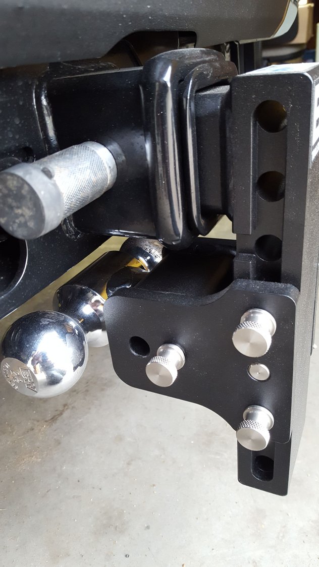

I posted this in another thread last week. This is the B&W tow and stow with a 7" drop. I don't think anyone would need more than that unless you plan on lifting it. It's not a 3" shank but the 2 1/2" gives me 14000# which is plenty for my bumper pull stuff. What I like about the B&W is: I can lock it with only a locking receiver hitch pin (when the ***** are in the stow position they can't be removed if the hitch is locked into the receiver) and the fact that in the "stow" position it's out of the way from my shins. Also I see no need to remove it to store it and take the chance of getting my truck greasy.

B&W has some smart engineers. See that groove in the side of the tubing? That is how you remove the ball assembly. With it locked into the receiver tube you can't get the assembly high enough to remove it
