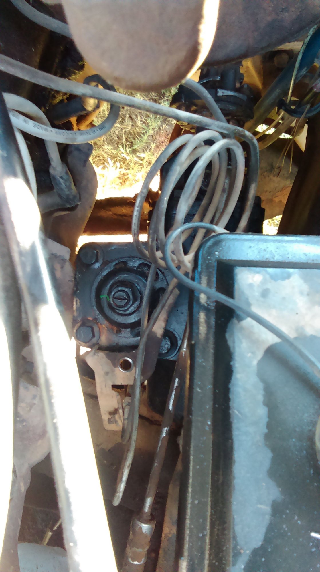

Old Sep 9, 2016 | 04:51 PM
fordguy98's Avatar
fordguy98
Joined: Mar 2015
Posts: 272
From: Texas
It's not a very good picture but this is my main concern. The steering box (not original) is butted up against the exhaust manifold. I'm not sure if a set of long tube headers will fit but I'm hoping huggers will. I'd rather have long tubes just not sure if they'd fit. What do y'all think?
Old Sep 9, 2016 | 06:39 PM
gatorfor88's Avatar
gatorfor88
Joined: Jan 2013
Posts: 3,512
From: Panama City
I think you are gonna play hell finding "block hugger" headers for a Ford.
Old Sep 9, 2016 | 06:42 PM
fordguy98's Avatar
fordguy98
Joined: Mar 2015
Posts: 272
From: Texas
I'm not sure if their true block huggers but I've found "huggers" on eBay. They may just be shortys that their calling huggers
