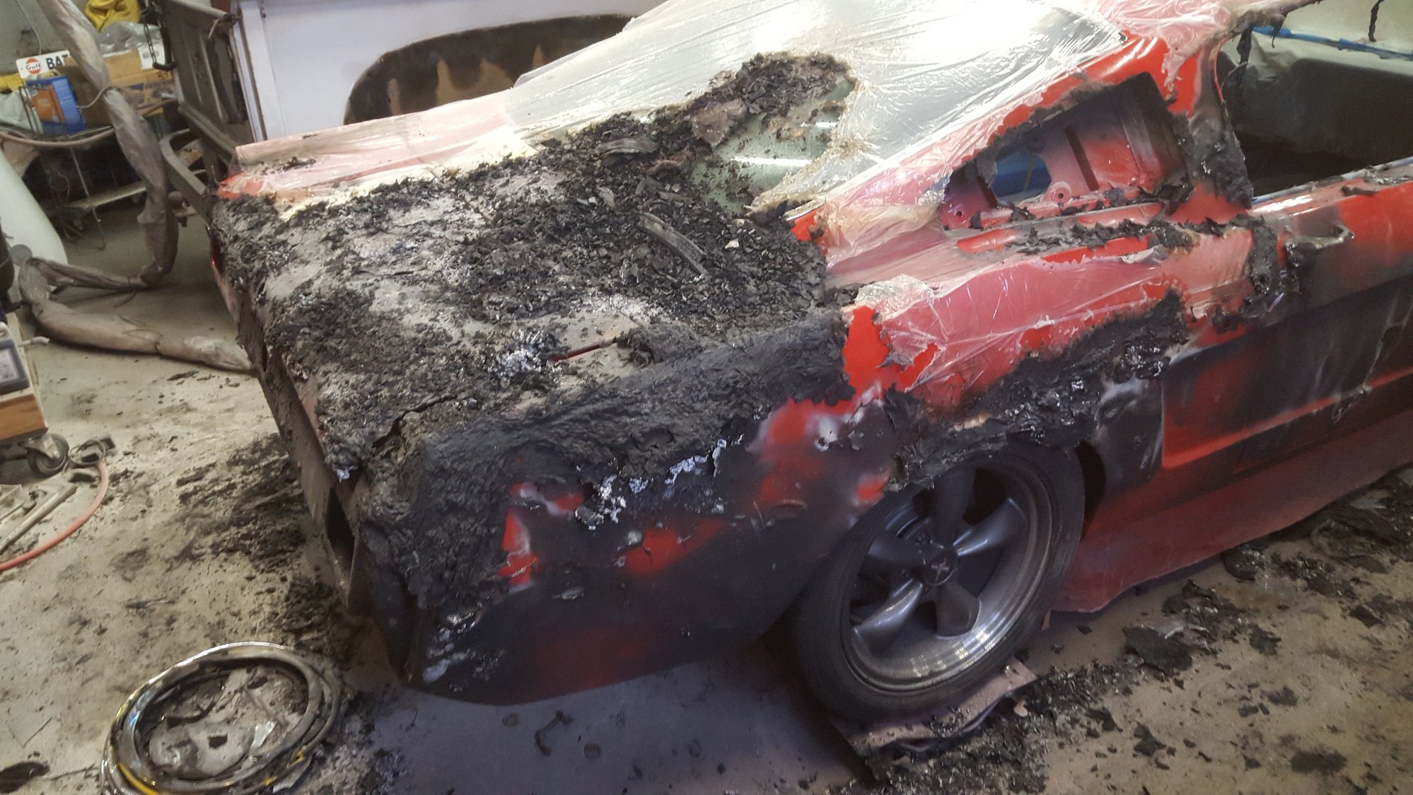

Know what you mean. 4 years on it and was in the rap up stage when I had a fire in the garage on good Friday this last spring. Now having to break the car down and repaint it. Was a bad day

From: W. Pa
Ouch, that hurts.
