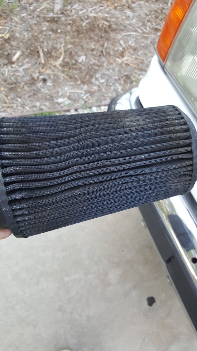

Maybe this air filter has something to do with my low mpg? Just about as dirty as I've ever seen
