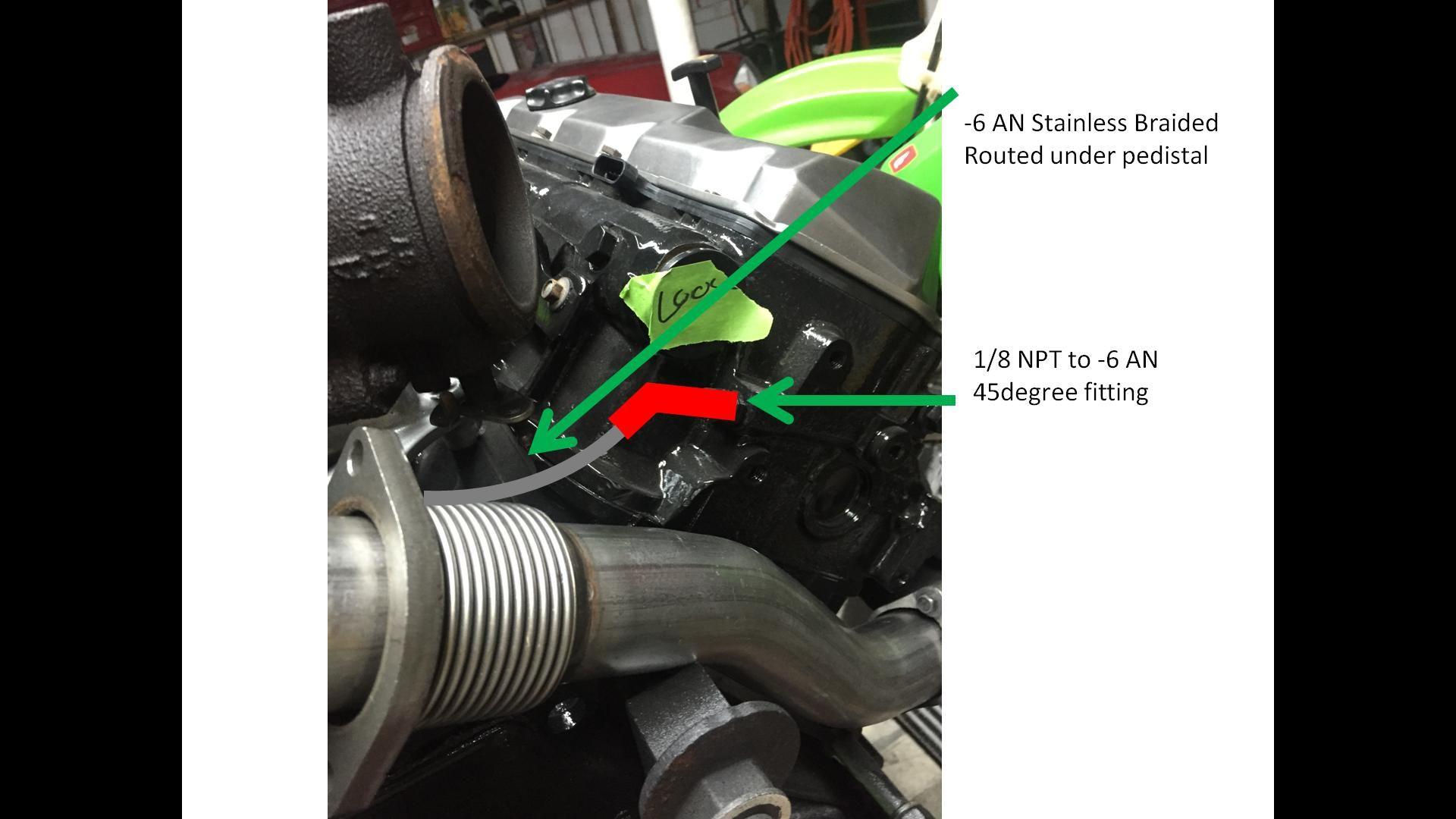

Question/Opion #2 is about the supply lines that run to the back of the heads. Basically my plan is as followed, use a 45 degree 1/8 NPT to -6 AN fitting on the passenger side head and run a 12" long pre-crimped -6 AN stainless braided line to a 3 way air connector with the correct adapter fitting. I was goind to run that line under the pedestal. For the Driver side head I was going to go with a 90 degree 1/8 NPT to -6 AN fitting to another 12" long pre-crimped -6 AN stainless braided line to the 3 way air connector with the correct adapter fitting. I was going to run this line however around the compressor housing and not under the pedistal like it did with the factory banjo bolt. Here's some pictures to kind of visualize all that.
I've seen guys both use hard fuel lines like the factory banjo bolt has running off itself and stainless braided as well. I know the Beans kit uses stainless braided to supply the heads in the rear so I'm assuming it's ok to use braided stainless lines as they are a reputable company and wouldn't be putting out a kit that uses them if they couldn't hold up to the heat....but still having that braided line that close to the turbo kind of worries me.
Was most likely going to change the fittings on the front of the motor as well to 1/8 NPT to -6 AN and run - 6 AN braided line up front as well because the regulator has -6 AN fittings on it as well and because the factory lines I have are looking brittle and dry rotted and rather replace them now while it's easy then have them go later down the road and cause a big mess.
That's about it, everything else I got figured out and ordered already but like I said my main concern is using the braided line that close to the turbo.

I did the thermo Tech heat tube.
3years and no issues. I too was worried but all is well.

Good to know! I'll look into the heat tube you mentioned, i was originally thinking spark plug wire insulation but just from a quick google that stuff looks like it would be the better bet.
