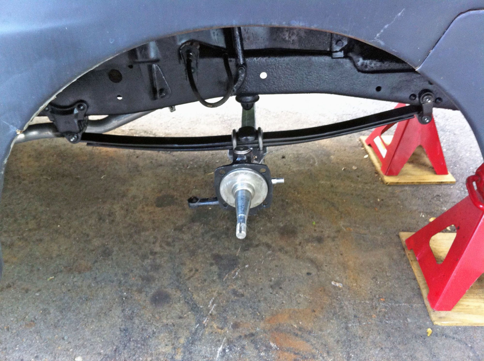

The reversed eye goes to the front. Here is how I mounted mine. As you can see they fit right under the jounce bumpers so there was no offset to the rear. I would call Posie's directly. They were always most helpful when I had a question and they make the springs right there in Hummelstown, PA.
The red jack stands are in the front.
