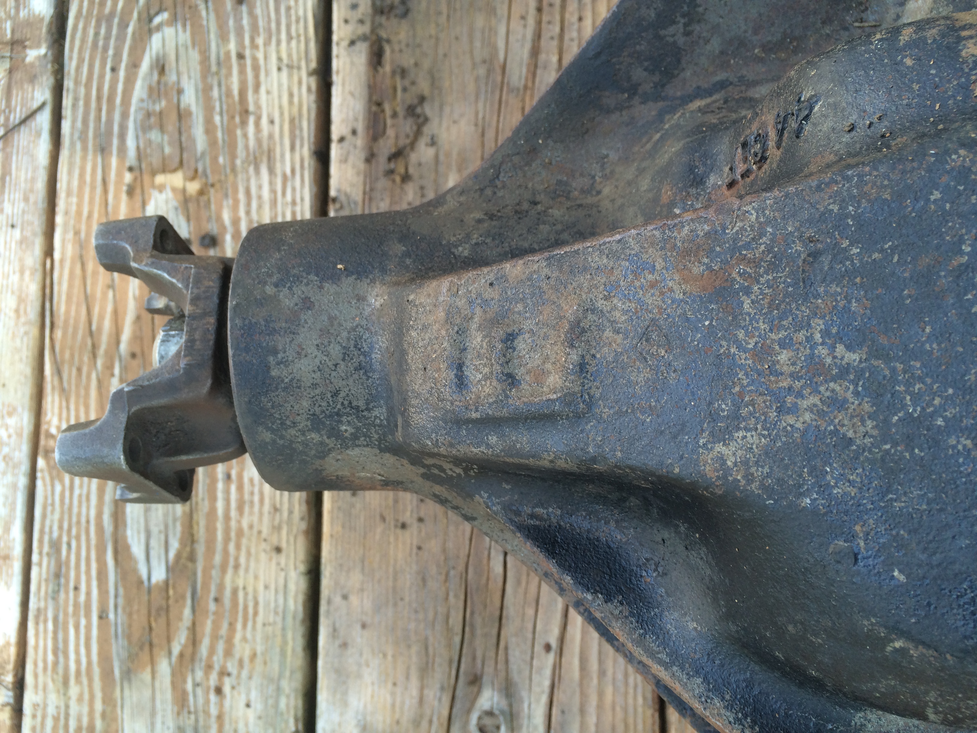

Numbers, the stamped number on the axle tube is 603763-1. According to this number on the chart it should be a D44HDF housing casting. Also, per this number it's a D6TA. It does state "no" on free running hubs though. Does that mean it came out as full time 4x4 front diff? Could it have been changed?

KsHighboy's Avatar
KsHighboy
Joined: Apr 2006
Posts: 323
Here's the cast E
According to this number on the chart it should be a Dana 44-6HDF w/a 3,500 lbs. capacity front driving axle.
Also, per this number it's Ford: D6TA-BD It does state "no" on free running hubs though. Does that mean it came out as full time 4x4 front diff? Could it have been changed?
D6TA-BD - Dana: 603763-1 (44-6HDF) 4.09-1 without free running hubs or Limited Slip: 1976 F250 Regular Cab 4WD with A/T before serial number B50,001.
The Warn hubs were added by a previous owner.
