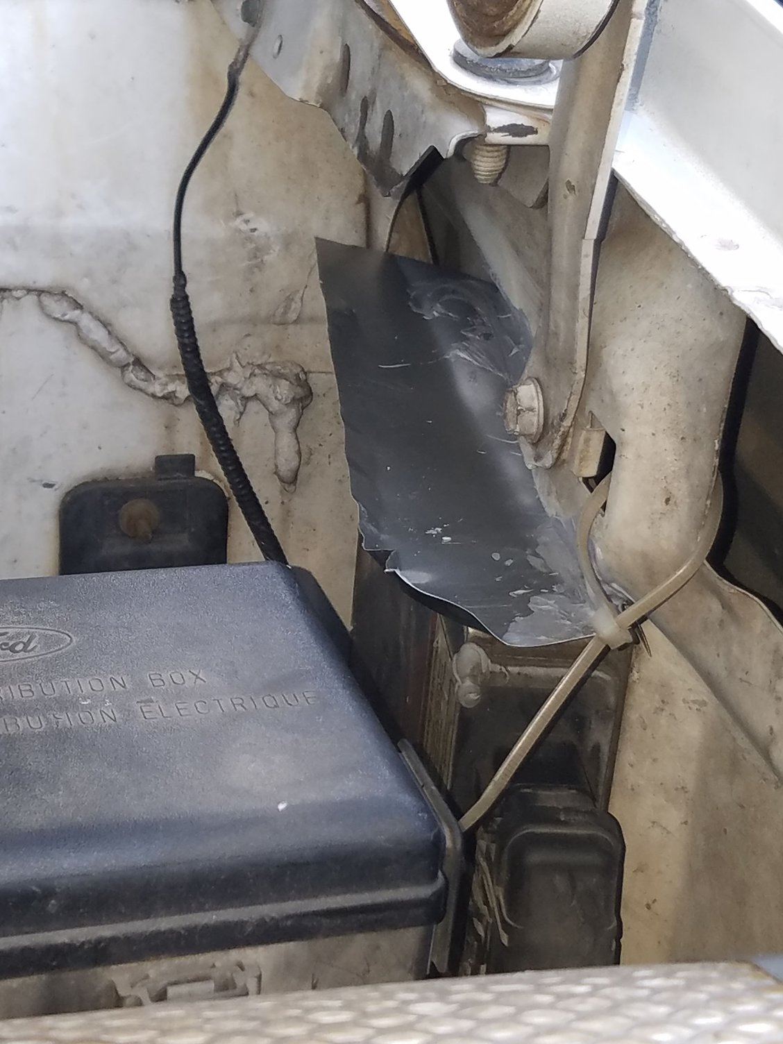

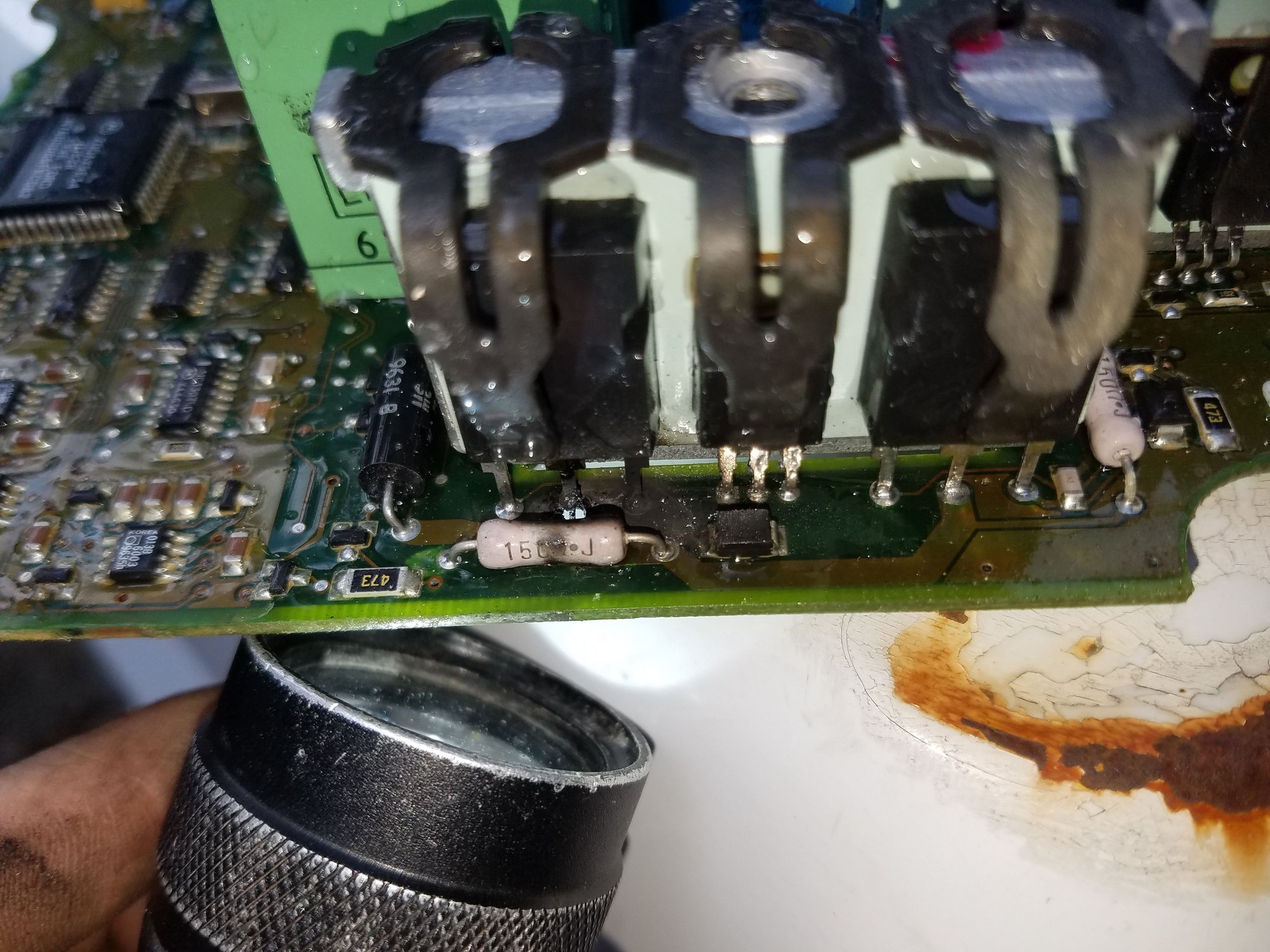

Last update on this one. Truck is running fine. Opened the old IDM to see if I could dry it out for a spare......
I could smell the burn as soon as I cracked the lid open
If you look real close you can see the solder burned out.
I'm a Ford guy, but every now and then I want to kick a Ford Eng. in the nads, and a "computer" in a drip area is one of those times.
Maybe that will help keep the water off of the IDM?

Oh wow! Sucks to see but comforting to actually find a problem when you're having trouble. Better than chasing electrical issues which I hate with a passion!

Exactly, It's great when you find right where the magic smoke escaped..haha And a 1 hour round trip to a salvage yard, and $125.. Heck, that's not a bad repair day.
