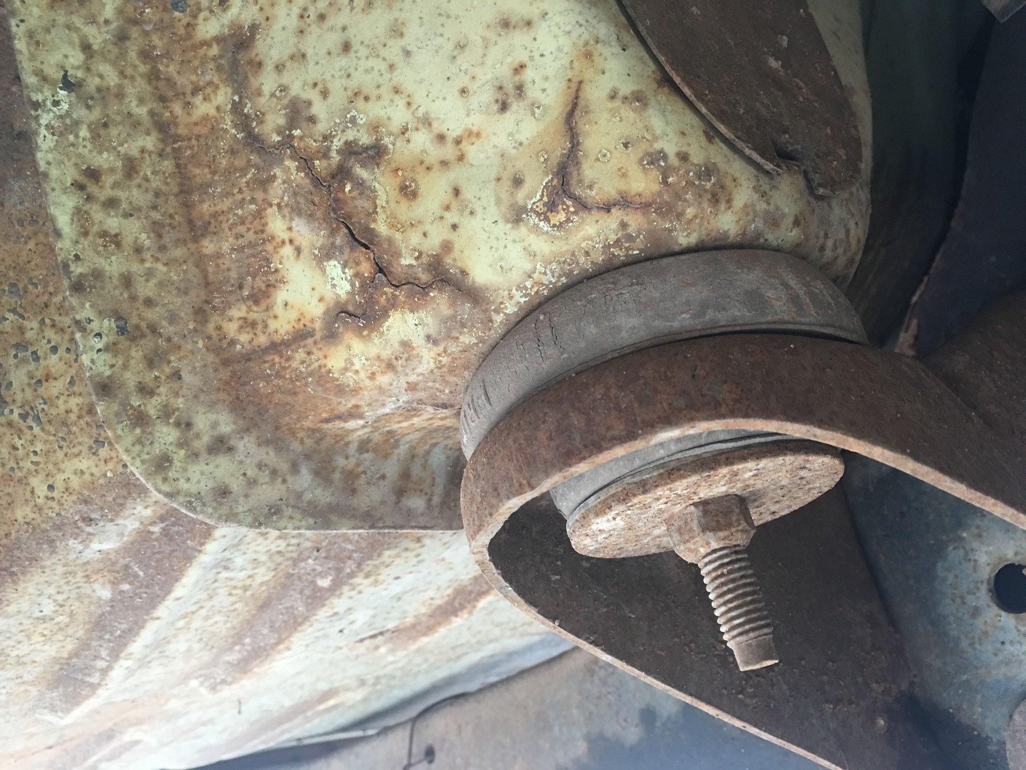

Passenger side. It's rusted but I don't know if it collapsed????

Originally Posted by Arnold Kenyon
Passenger side. It's rusted but I don't know if it is collapsed.g[/IMG]
That one is still largely intact. But look at them cracks!!! That zit is ready to pop!
Better order another one of them cab mounts!
You wouldn't happen to know how to weld would ya? It'd be cheaper cuz yer gonna pay a shop rate anywhere from $70 to $90 per hour.. A welding machine would pay for itslef real quick.
Yep, I know how to weld. my family had an irrigation company so I was blessed enough to learn how weld aluminum with TIG. Looked at mounts at DC will have to order them up. I need to buy a welder, just don't know if I want a TIG stick or TIG/MIG unit. Money, money, money.

If the floorboards are rusty, you need to replace those first, as the mounts weld to the floor board. Putting a new mount on a rusty base won't go over very well.

Not looking good for the supports.

Mmmm.... like a rotting onion.
Be best to to a stem to stern evaluation to understand the breadth of your undertaking.... and the potential costs of time, money, and effort it will require. .. but at least your already ahead by knowing how to burn metal.

Also check for rot at the two radiator supports at the front of the frame.
