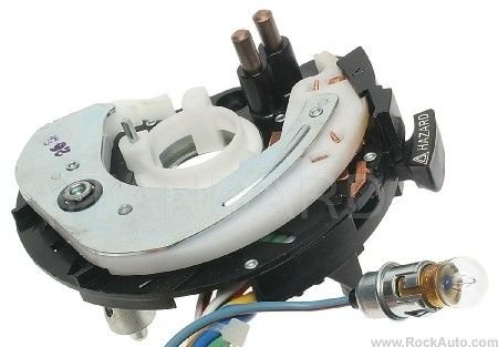

I'm having an issue where if one signal is on, the opposite brake light won't illuminate. Also periodically the signals will not illuminate on the dash either. If I wiggle the turn signal lever towards me everything will start to work again. Something is shorting out in it.
I plan on replacing the whole switch. 1980 non-tilt wheel. All the switches for non-tilt wheel I can find show a bulb on them. My truck has no bulb coming off the switch. What is this bulb for and will a switch with a bulb still work on my truck?

What is this bulb for (A/T shift indicator dial) and will a switch with a bulb still work on my truck? Yes.
E1HZ-13341-K .. T/S Switch / Obsolete
1980/83 F100/350, Bronco & Econoline with A/T & M/T without Tilt Wheel / 1980/89 F/FT600/900 A/T & M/T
MCDONALD OBSOLETE PARTS in Rockport IN has 1 = 812-359-4965.
GREEN SALES CO. in Cincinnati OH has 2 = 800-543-4959.
CARPENTER NOS OBSOLETE PARTS in Concord NC has 9 = 800-476-9653.

Thanks for the quick reply. So I should be okay to remove it since I have a manual transmission?

Leave the wire there, just remove the bulb.
