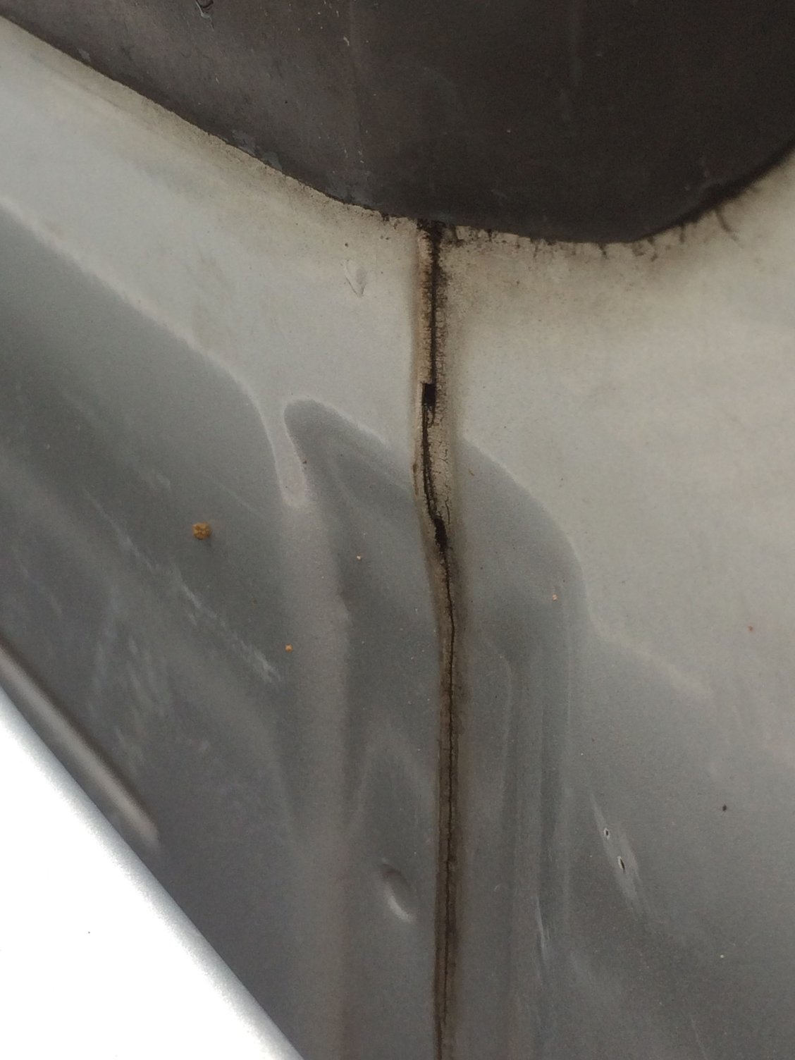

Passenger floorboard was wet when I bought it. In January.....I figured from PO getting in and out with wet boots maybe.

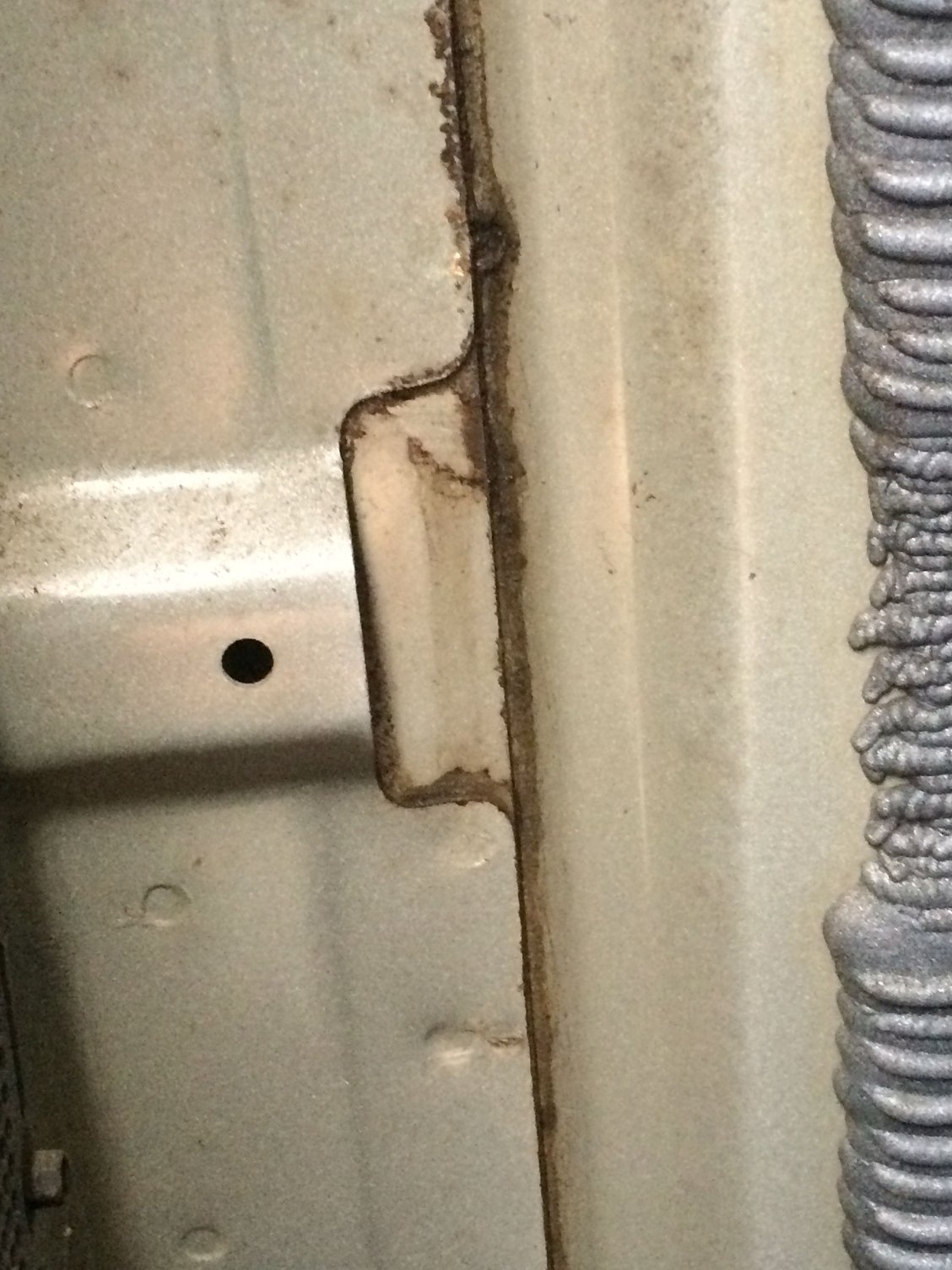

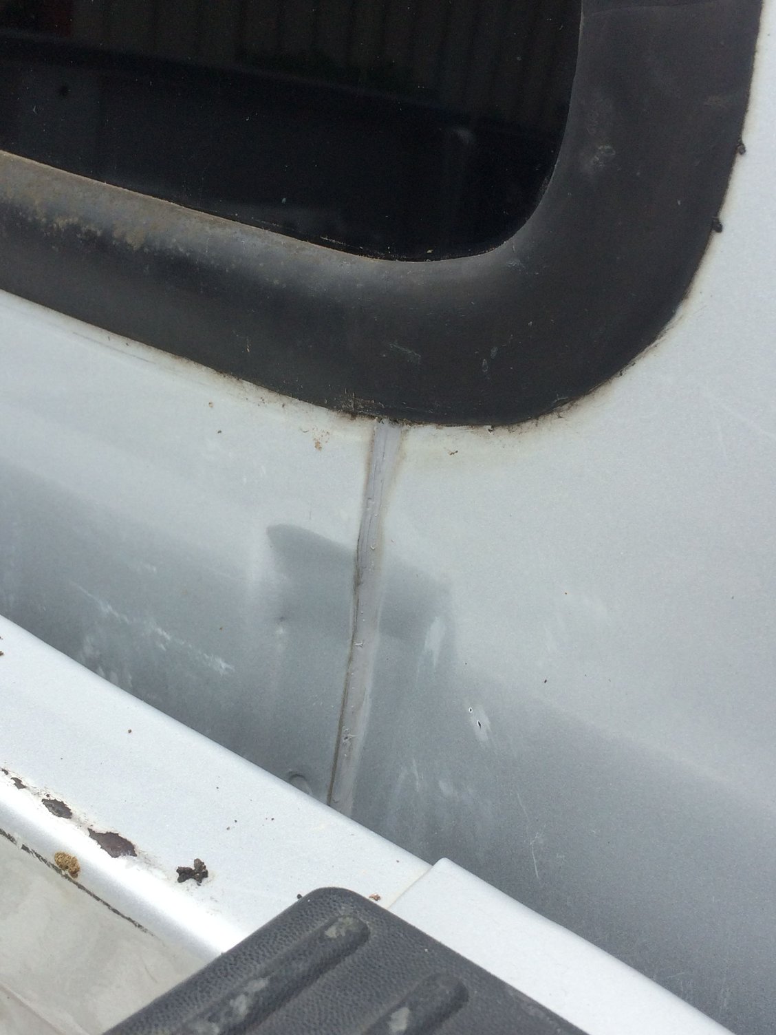

It hasn't been wet again until today after about 14 straight days of rain. Peeled up carpet. Wet all the way to firewall, but firewall isn't wet anywhere. Flipped passenger seat up and peeled up carpet and trim. Water has evidently been leaking from the seam below the windshield where the cab was assembled. Fixed with gray permatex. Inside and outside. Heads up to all you fellas with wet floorboards.

[QUOTE= Water has evidently been leaking from the seam below the windshield where the cab was assembled.[/QUOTE]
Can you put a photo of the suspected area ?
