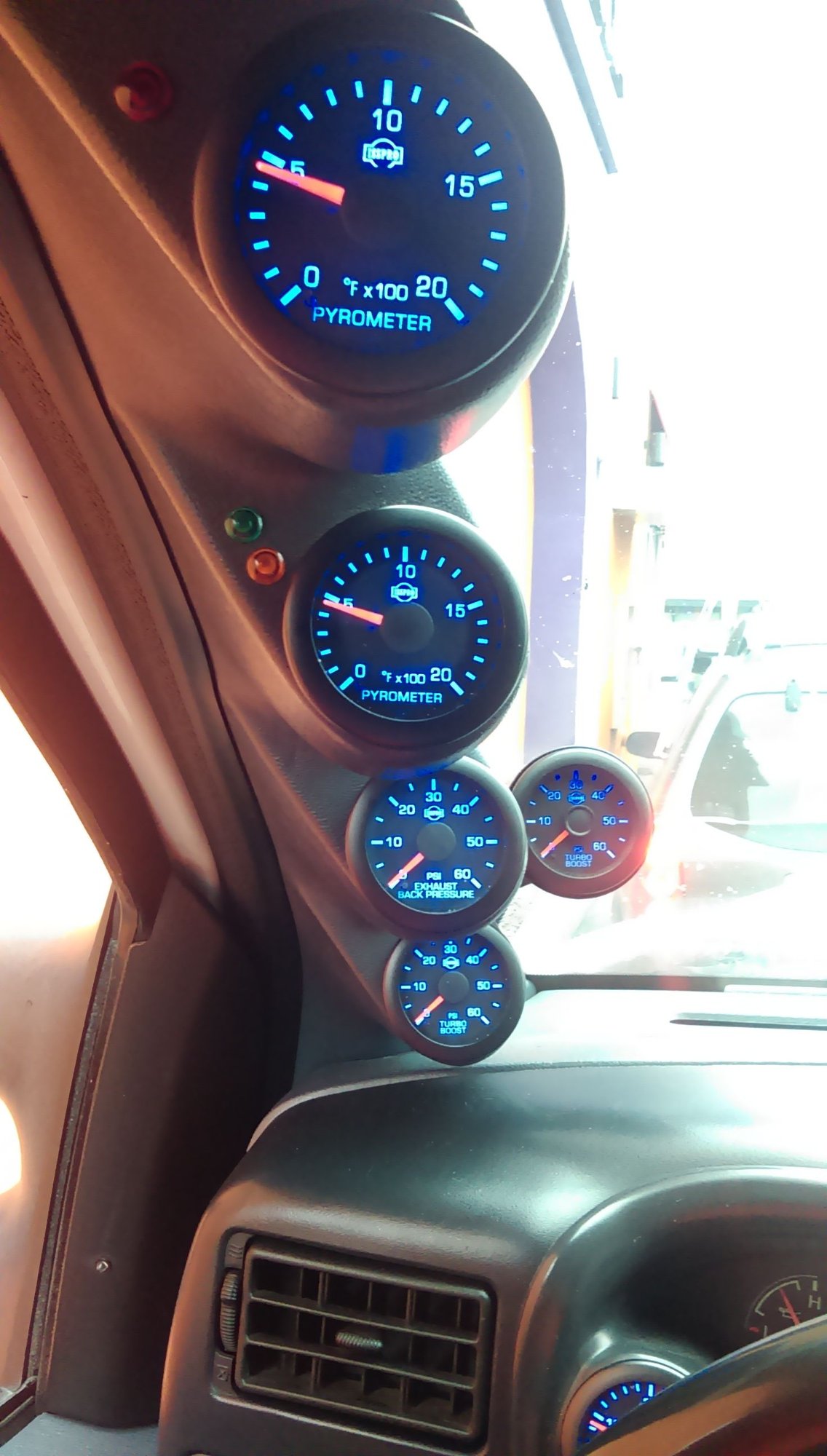

I just ordered a second EGT probe and it looks like it might come up short in length to install on the passenger side, it will be the highest gauge on a pillar triple pod. Its an Isspro Ev2.. How is this handled.. Just extend the pigtail before connection ?

Run the cable to the passenger side in the cab (depending on your gauge location - mine is below the dash), then go through a grommet there. If you are on the A-pillar, you might have to order a long cable from ISSPRO... because I'm not so sure splicing works with that special cable. The solid-conductor wire is the weak link.

I want to say the thermocouple used requires that exact length of wire that the unit comes with to operate correctly / accurately . The same is the opposite of it is too long, you can't cut it to length.

I don't think adding wire to the thermocouple to extend it will work. I am sure it will mess with the readings, as the milivolts sent to the gauge will probably change with different resistance. Never personally tried it though, so I cannot say for sure.
I would just order a longer thermocouple.

And yes, you can extend the wires on Isspro EGT probes. Use Butt splices, NO solder.
