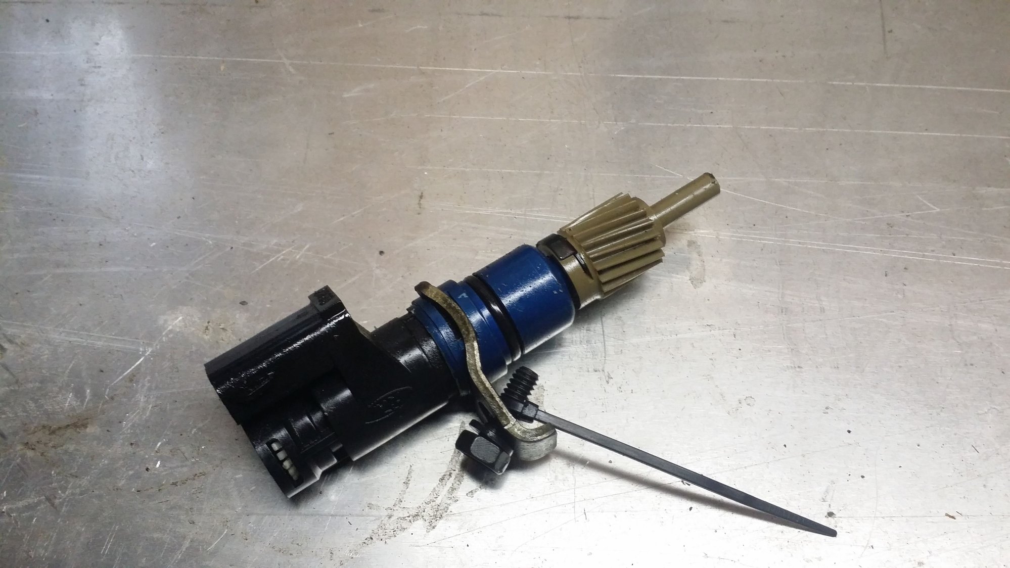

This is a VSS I removed from a 1998 3.8L Mustang 4R70W electronically-shifted 4-spd overdrive transmission that I'm rebuilding to go into my F100 ....but, that's another story....
It's probably hard to tell from the photo but, the hole is blocked off by the white plastic object so that a mechanical cable is not used in conjunction with this VSS. It sends the speed signal to the ECU/PCM to operate the speedometer and to control the shifting of the transmission in its original application.
Somewhere around my shop, I have another VSS for a T-5 manual 5-spd overdrive transmission from a 1990 Fox 5.0L Mustang GT. It not only has the two-wire electrical connector but it also has a mechanical speedometer cable going to it so, the VSS does come configured either with or without mechanical speedometer cables.
Late model Mustang suppliers and various other suppliers have the VSS available brand new for use with a mechanical speedometer cable from Late Model Restoration.com .
https://lmr.com/item/LRS-9731B/83-93...g-Speed-Sensor
VSS for use without a mechanical speedometer cable.
https://lmr.com/item/LRS-9731A/94-98...g-Speed-Sensor
