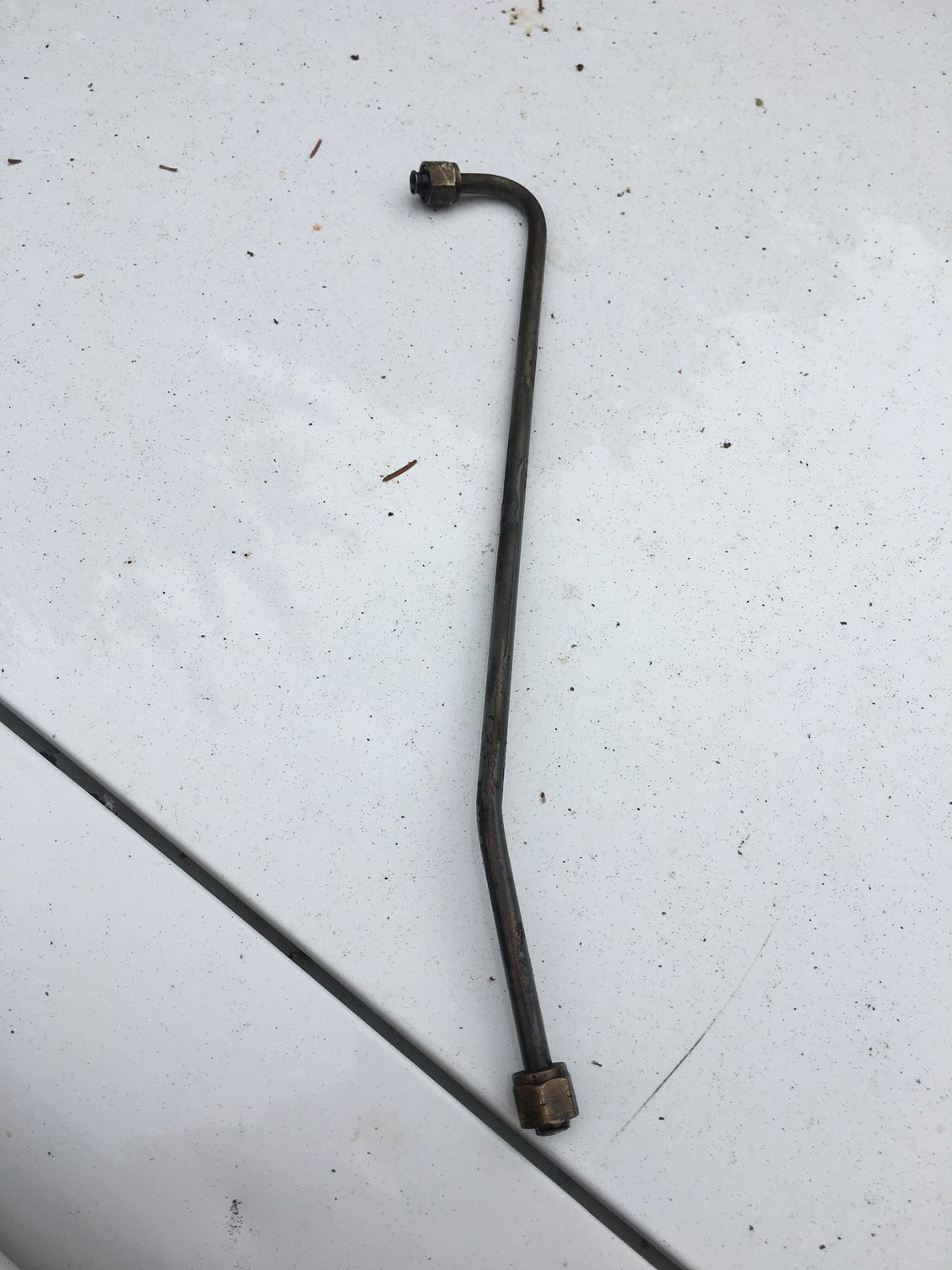

So I've had a problem with "air in the lines or water" as I tried to jimmy rig or fix the fuel supply line I believe that's what it is I'm not sure it's a steel hard line that runs from the fuel filter to the injector pump I've called everywhere even salvage yards where can I find it how do I fix this I have a 85 Ford F-250 6.9 turbo diesel please help me I know this is the culprit because I can watch it leak I changed all the hoses and clamps brand new

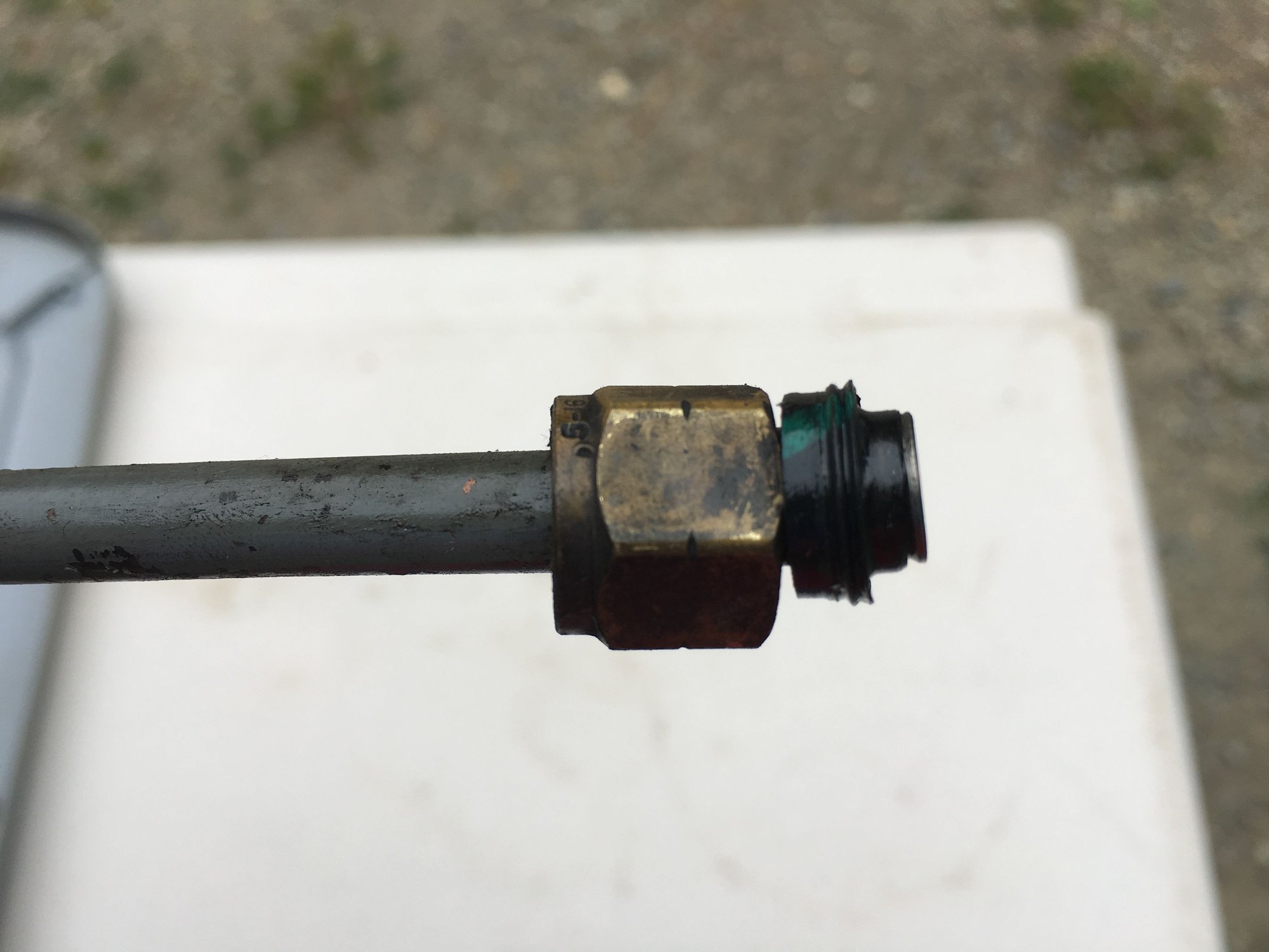

the piece you need is called an "olive"
part#E3TZ-9K260-A filter to injector pump, 2 needed. purchase here:
E3TZ-9K260-A | SLEEVE FUEL LINE CONNECTOR | OEM Ford Parts for $2.54 each
part #E3TZ-9C397-A fuel filter inlet from fuel pump, one needed:
E3TZ-9C387-A | RING FUEL PUMP SLEEVE | OEM Ford Parts $1.86 each

Type4 on here has return line kits that include those and are reasonably priced. If the olives are bad, chances are the return lines are shot too.
