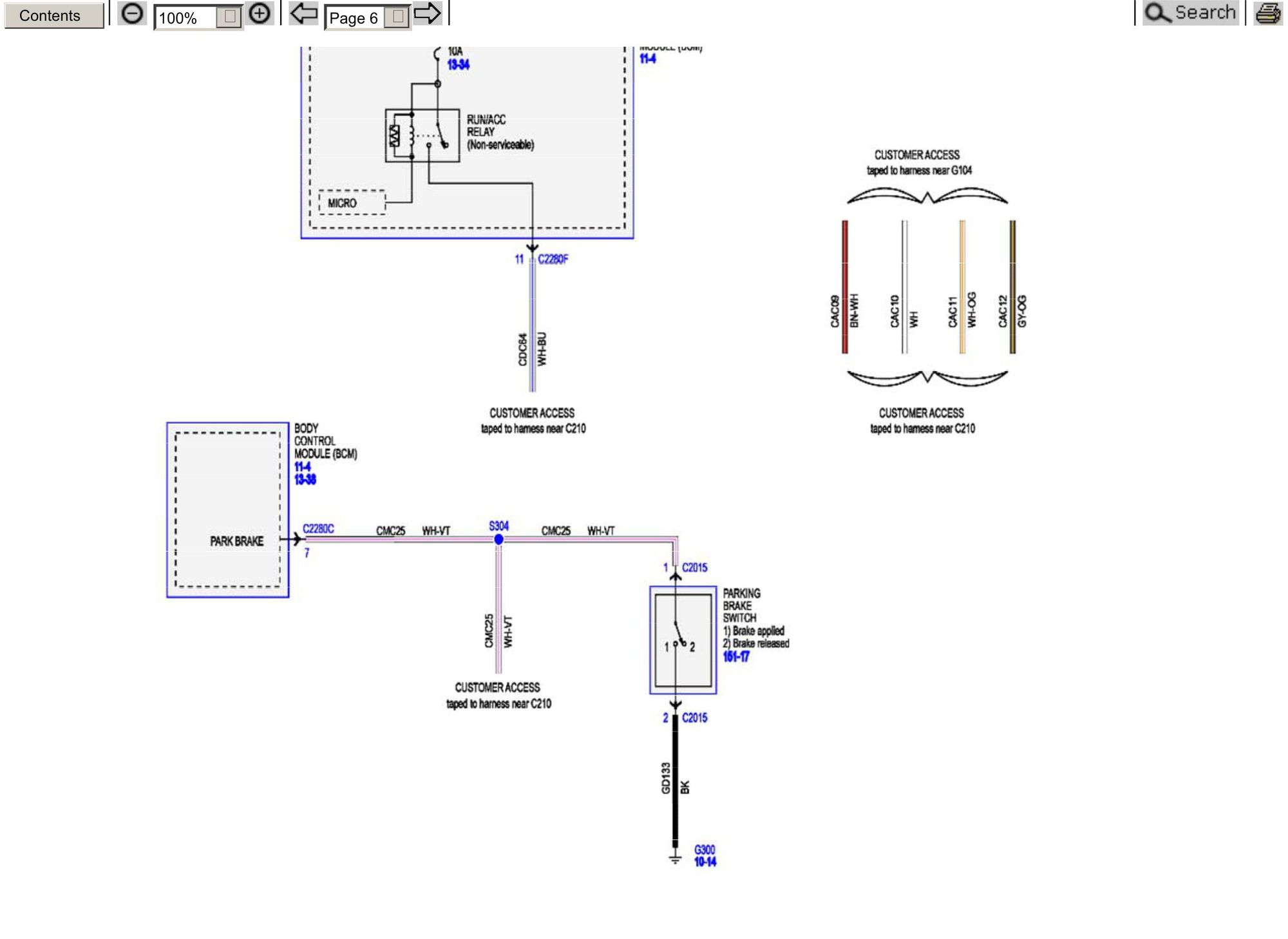

Here is the Customer access wiring in the cab of the 2011-2016 Super Duty trucks from the 2016 Ford Service DVD

I vote for tech file as well. Very helpful.
