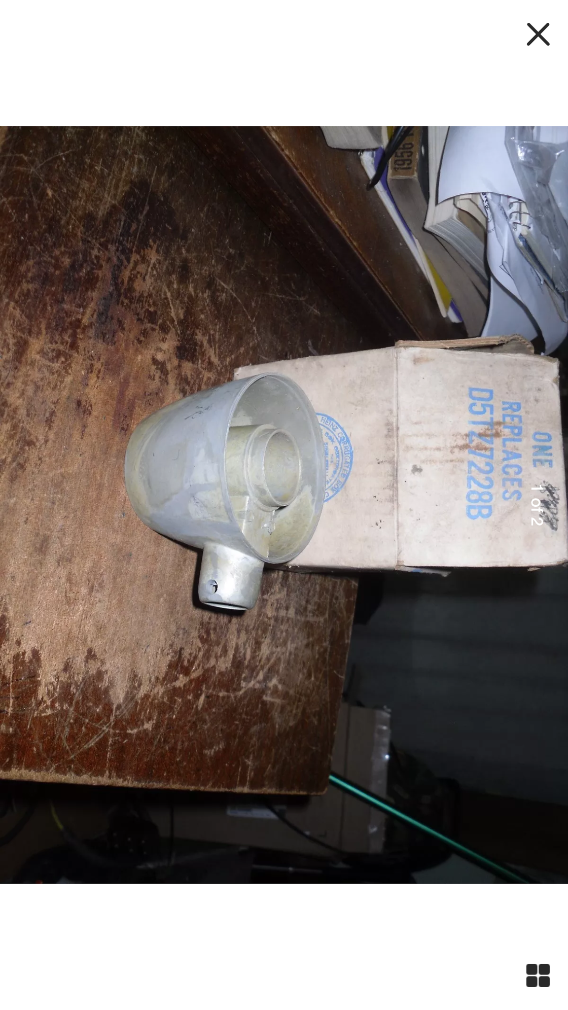

I am curious as to where you got that brass looking pin. I bought a shift collar and its missing the pin and it looks like yours is the right type. I can't find that pin by itself anywhere.

Originally Posted by JEFFFAFA
Is this what you need?
I bought this and the top is 5/16 and the bottom is 1/4

I kept the old roll-pin. It is a 3/16 diameter.
On my steering column, the roll-pin is a press fit into the lever and a slip fit into the housing.
The holes in the housing were worn out so I drilled them out and pressed in some brass bushings.
-David

I just caught the D5TZ7228B part number on the box you posted. That's for a 3 on the tree not A/T. Ford originally listed that part number included in the box a 357479-s15 3/16" pin and a C8AZ7D439A 1/4" pin. Below is a Evilbay pic of the C8AZ7D439A.

[QUOTE=JEFFFAFA;16660229]I just caught the D5TZ7228B part number on the box you posted. That's for a 3 on the tree not A/T. Ford originally listed that part number included in the box a 357479-s15 3/16" pin and a C8AZ7D439A 1/4" pin. Below is a Evilbay pic of the C8AZ7D439A.
Items in search results
Thanks I think thatll work! Appreciate the expertise.
