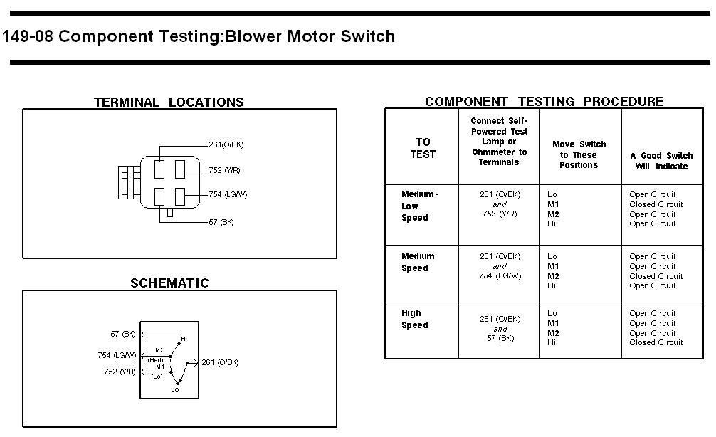

Most likely the switch since the resistor is out of the circuit on High.
Info to test the switch:

But I think I may have described it wrong: it's not high speed doesn't run, it runs but doesn't produce high speed. So now High is the same as M2...

Check the switch

Here is the real deal: the blower speed switch works fine, each step produce the right speed.
