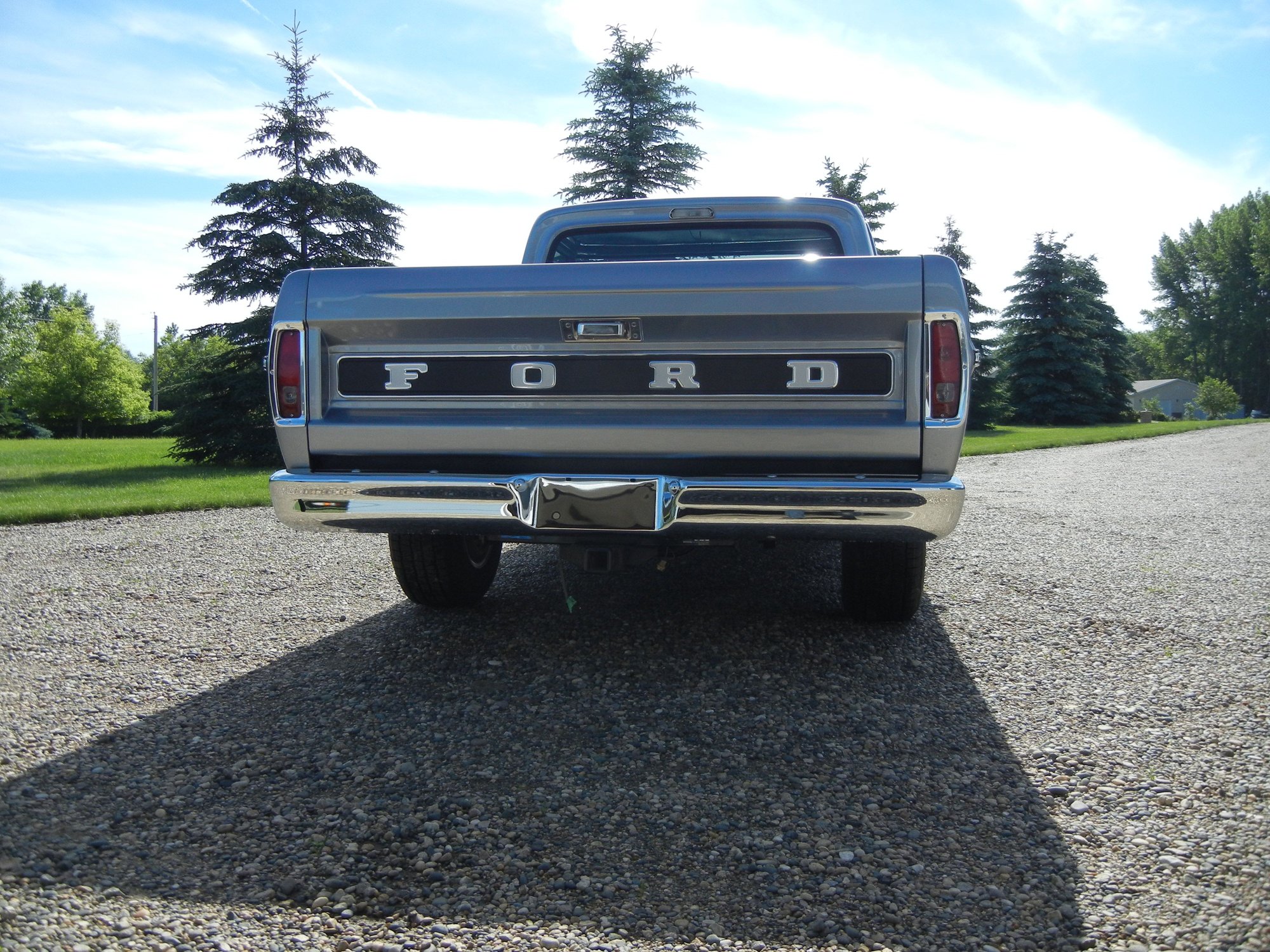

Perhaps you have a Dentside bumper that's for a 37.5" width frame instead of a Bumpside bumper that would be for a 33.5" width frame. Or, maybe you have a bumper for a Bumpside and mounting brackets for a Dentside (?).
The Bumpside and Dentside contour rear bumpers are the same width and shape but, the bolt hole spacing for the mounting brackets will be wider apart for the Dentside bumper compared to a Bumpside.
Contour rear bumper and bumper brackets I bought through NPD.

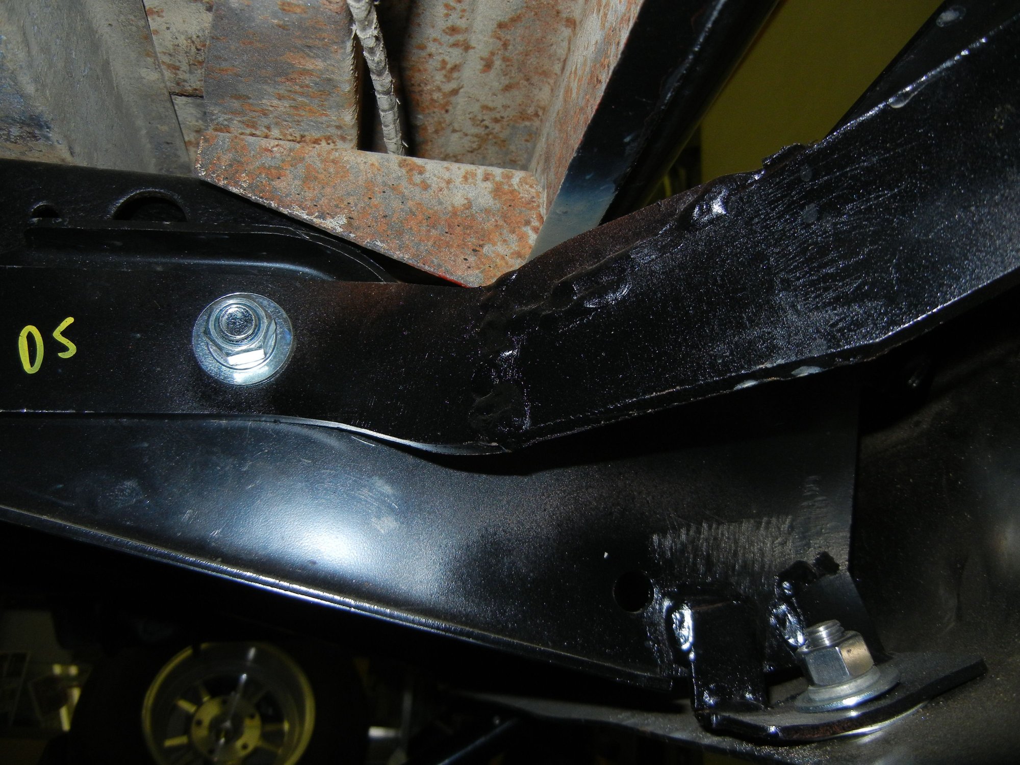

I bought my brackets from Dennis Carpenter and the bumpers from Goodmark Industries. The brackets were terrible. Holes lined up more or less but the metal surfaces were not flush. Angles were out. I was afraid to tighten the bolts and bend the bumper. The outbound brace angles were way off. I cut mine up and rewelded them. I also used those wavy washers between the brackets and the bumper. In the end the bumper ended up tipped forward a bit but it was the best I could do with those brackets.

Look how much the bottom was out. And the outward brace was poorly bent and didn't line up nice. I cut it right in half, bolted both sides on and tacked it back together and reinforced it.
