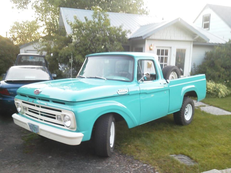

Here is a picture of my pickup,
I am unable to get a photo currently for what I'm describing as the truck is 45 miles away. But it does have the earlier body style bed on it, and I'm 99% sure this is the correct bumper for my pickup. I just don't know if the back edge (the edge that faces toward the front of the pickup) is supposed to be flat, or if it curves away from the pickup in the middle.
I wish I could describe it better for you.
