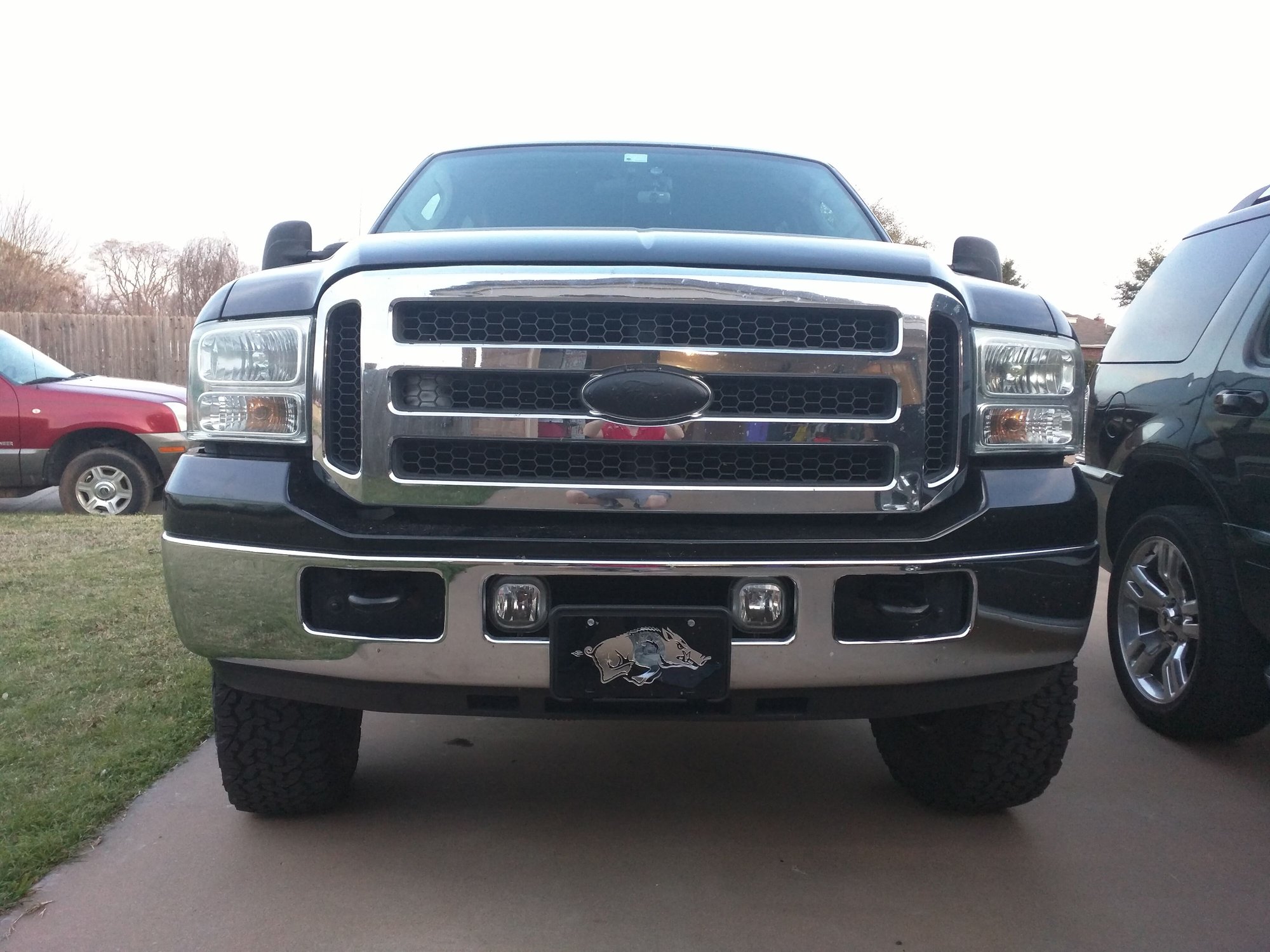

Im using the Derale 13090 kit mounted behind the grille. Those plastic magnafine filters come apart at the seam and leak over time. This setup takes the easy to find FL1A filters and I keep a strong magnet on the bottom of the filter. The grille comes out in less than a minute to change the filter and I like to think keeping it up front in the wind helps cool things a slight bit. Also, my next filter will be a black WIX so it will blend in better. So far so good.
