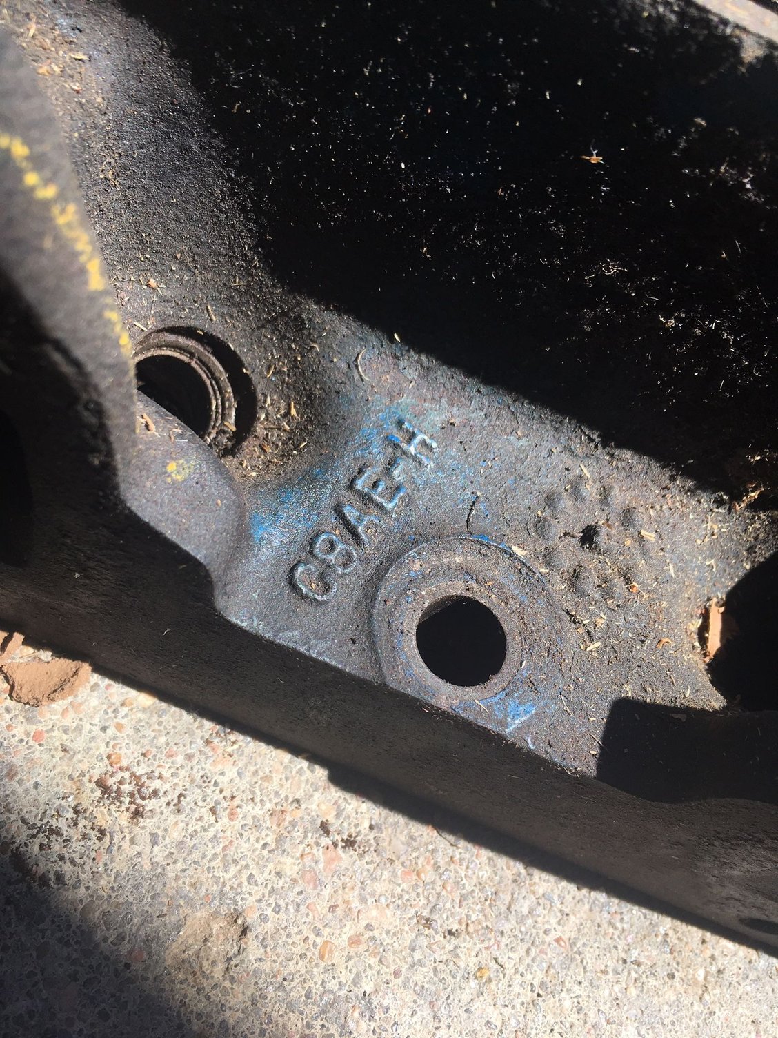

Old parts
I bought a engine in 2012, removed from a highboy the neighbor had. This was the manifold, found it on a back shelf when cleaning with the wife.
Single plane, I think it had a 4 barrel carb on it. If I remember right, the carb was a large cfm Holley, but maybe I mis-remember.
The removed heads.
I thought about using the manifold on my '75 project...Anyone have any recent experience with the manifold and/or the heads from an older engine?

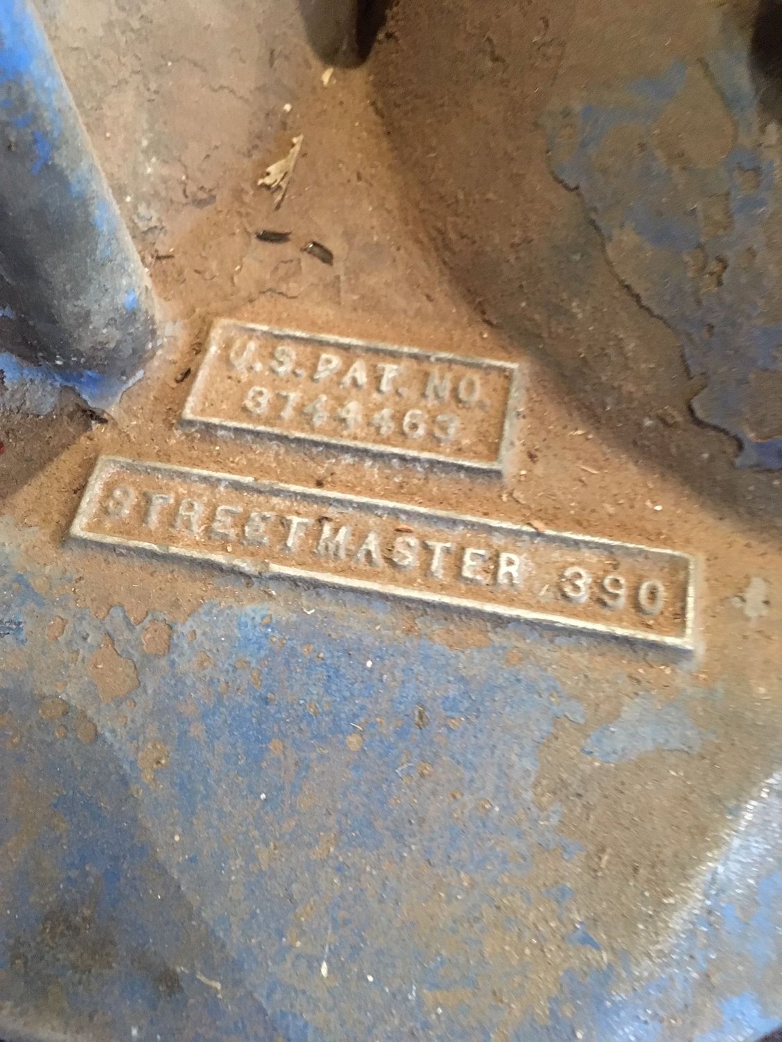

The intake pictured is Edelbrock Streetmaster 390. It is a very good and light weight intake. You could lift it with one finger - I have.
I would stay away from aluminum heads if you are on the budged.
390 is a very torquey motor. It takes a little to make it high performace. With stock components it is able to produce 400hp/torque with ease.
Buy quality stock components and CJ valves 2.09/1.63 or bigger such as 2.15/1.67(1.73) depending on your bore size. Select cam with correct power band and you are quaranteed to have a smile on your face when driving your pick up.
