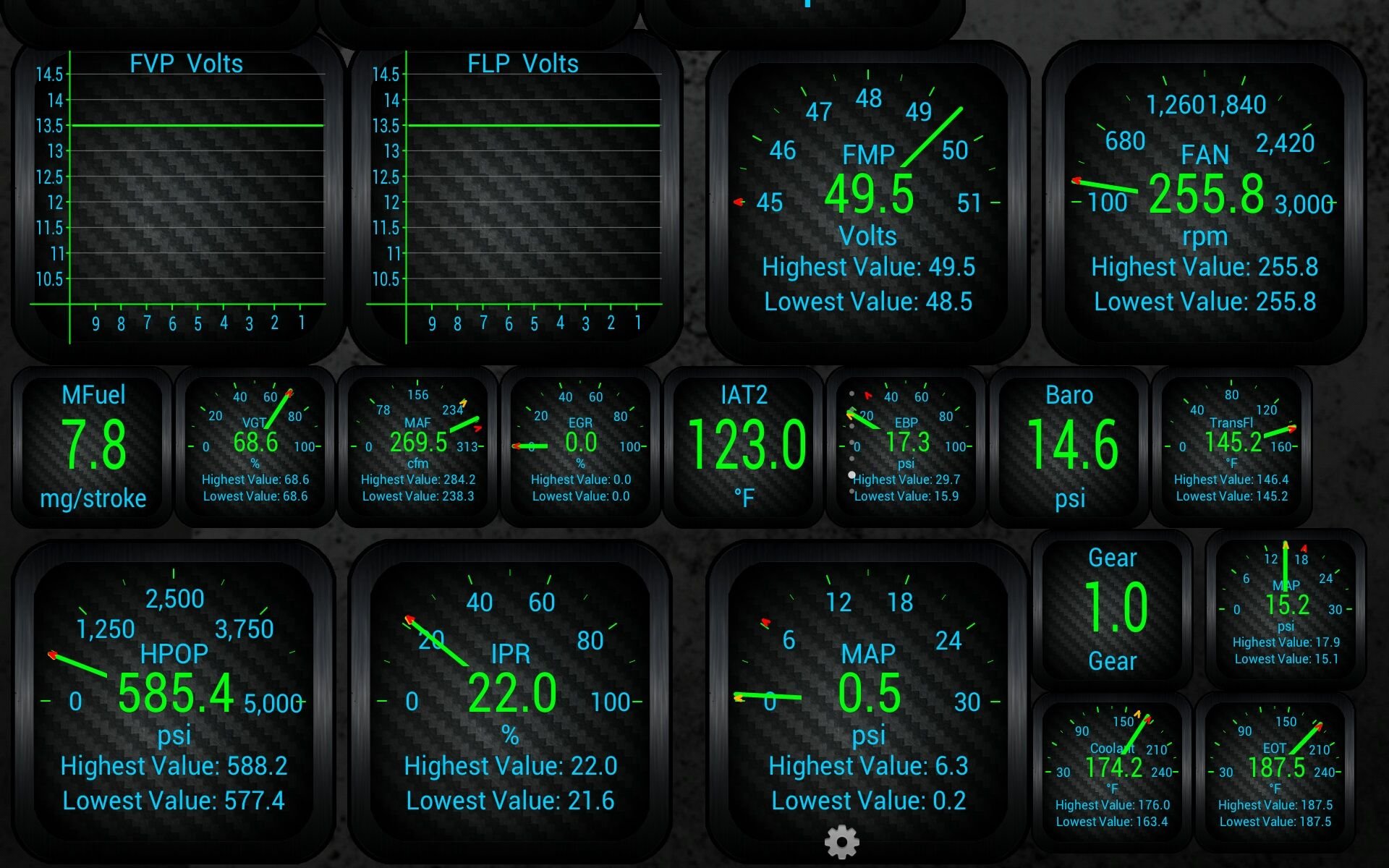

Originally Posted by JoshC017
Sweet! I'll be ordering that
That's the best part about Torque Pro. Pictured above is my current display. You can set it up anyway you want.
Old Jun 28, 2016 | 11:44 AM
  #41
FordBlueHeart's Avatar
FordBlueHeart
Joined: Jan 2010
Posts: 3,554
From: Mesick
I've used numerous setups.
