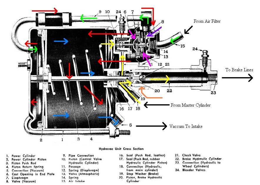

Bob, Firstly I have the Hy-Power not the hydrovac which is the diagram you provided.
This model has two lines to the master cyclinder... At first I could push the fluid through it for bleeding the chamber in the booster but now it won't budge despite confirming there are no blockagesin lines or fittings. I have removed both vacuum lines, the one from the engine and the one to the vent inside cab. Yet now I cannot get the pedal to depress much... it seems something like a check valve inside is preventing it but cannot find how to release it and start over...

Ok, sorry 'bout that. Your Midland must be the counterpart to my Bendix.
I thought the slave/power piston might be the culprit, also the ball-check valve.
Dave sez:
BRAKE PEDAL IS HARD AT DIFFERENT INTERVALS
  1. Defective manifold check valve.
  2. Slave cylinder piston sticking from inferior brake fluid.
  3. Brake booster air cleaner clogged.
  1. Clean or replace manifold check valve.
  2. Clean and recondition slave cylinder.
  3. Clean air cleaner in mineral spirits and blow dry with compress air.
It's a different Dave.
http://dave78chieftain.com/MidlandRoss.html
