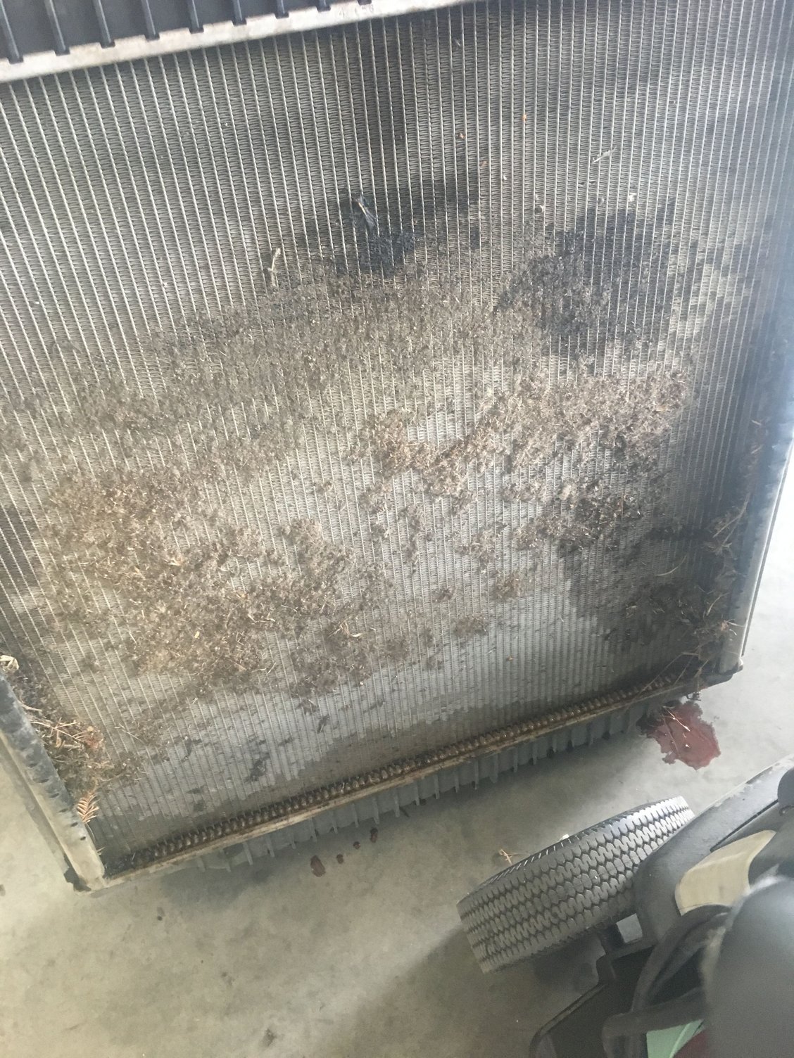

Ok finally have got to the bottom of this. Truck majorly overheated on a big climb up the Fancy Gap pass into VA. Turns out the radiator had a crack just to the left of the return inlet. One of the many diagnostic things that I had tried at the suggestion of an earlier post here was to have the radiator cleaned but I guess he just cleaned the fan side and never removed the radiator to clean it as evidenced by the photo that I wil try to post.
Truck runs at 185 to. 205 in most normal circumstances but will spike up to 220 on a climb (not towing) which I stil find odd but it will fairly quickly drop back down to normal levels
Thanks everyone for all the help and suggestions. I suspect the cracked radiator was secondary to the dirt as it did not show up under pressure testing while trying to diagnose earlier.
Just wanted to thank everyone who chimed in to help solve the problem and shed some light on what the problem turned out to be in the end. Hope that this is the end now
Regards Mark
