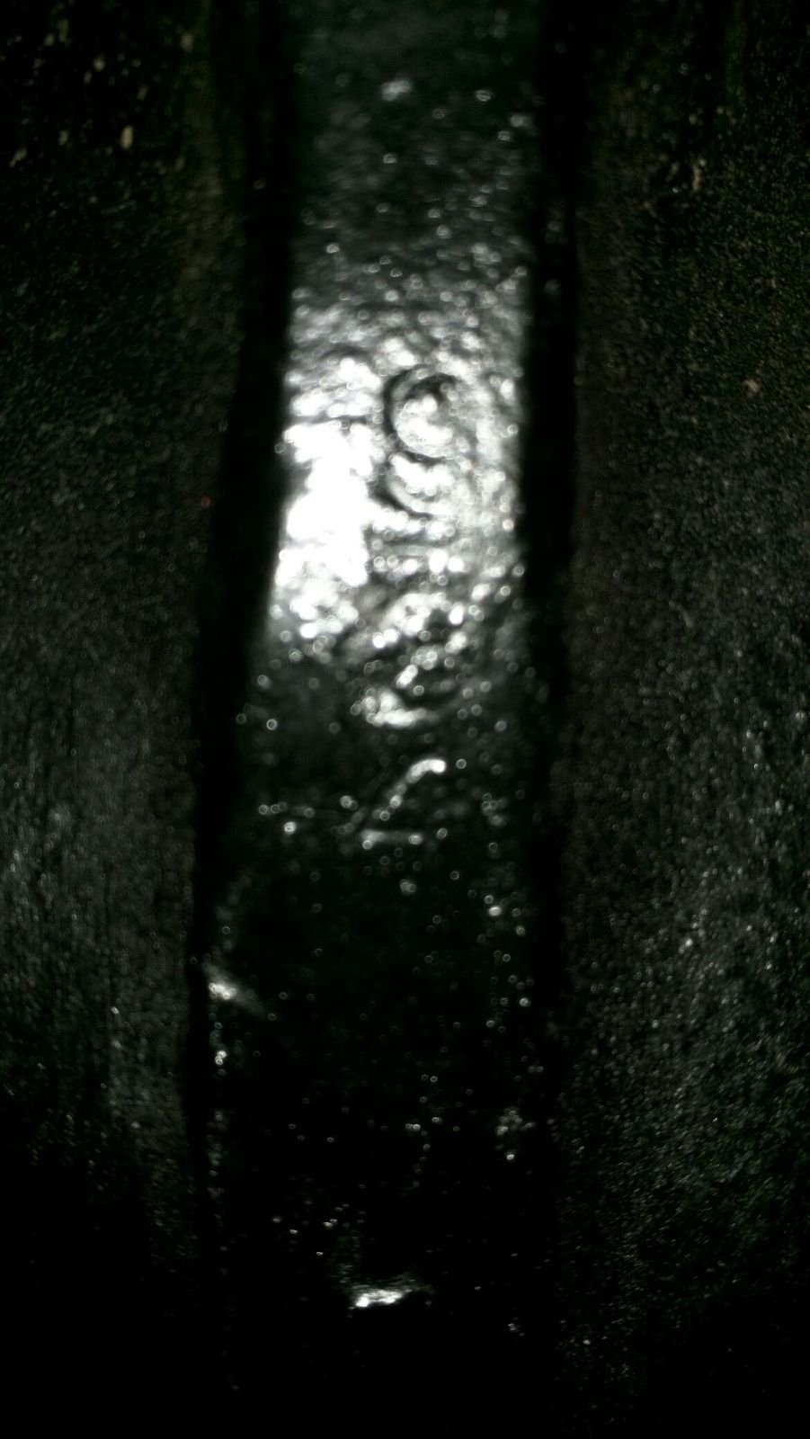

There is no tag on the axle. There should be a pair of numbers stamped into the bottom rib on the center of the axle. You have to crawl under the truck and look up at the axle. The two numbers are the ring and pinion tooth count installed in the center section at the factory. If you have a 3.78 ratio you should find a 9 and a 34. This is assuming that the axle ratio hasn't been changed in the axle during the last 75+ years.

Thanks Fred. Going to have Jr. get up under and look. My old eyes have scoured and scoured and I can't find any numbers. Frame has been painted (by hand; by a 5th grader) so I guess it's possible they filled in the numbers with paint. Seems unlikely. Pics as requested. I think its all original...

The stamping on the axle can be faint, and yours is probably filled in with paint. You may get to scrub or sand off some paint to find it. Here is a picture for reference:

If you can't find the numbers, or if you don't trust them, then you can just check the ratio. It is fairly easy before you put a radiator in front of your engine. Jack up one rear wheel (not both) and block the other so the truck can't move. Put the transmission in high gear. Mark the crank pulley on the motor with chalk and mark the raised rear wheel with chalk. Put a socket on the crank pulley and spin the crank clockwise. Have someone watch the rear wheel while you watch the crank pulley. When the rear wheel has spun two revolutions stop spinning the crank. The number of revs of the crank is your axle ratio. Just under 4 1/2 revs you have a 4.44, just over 4 revs you have a 4.11, just over 3 3/4 revs you have a 3.78, and just over 3 1/2 revs you have a 3.54. Give it a try and let us know what you find.

Well JR (younger eyes) finally found them. Hard to read but the '4' and '9' are quite definable, so I'm guess its a 40 to 9 / 4.44. Going to do the crank/tire count this weekend to be sure.
Got it to sputter and cough last weekend. Points weren't correct but new ones on way. Should get it running good this weekend.
@newold46... It came with the car and was brand new, with the except of the mouse condominium inside.
9 at the top, 4 at the bottom, messy in between.

YIPPEE. Its a 3:78 according to the crank revs. Big relief. THANKS!

Hidden under the paint somewhere is a 3. 34 divided by 9 gives you a 3.78 axle. In my opinion it is the nicest overall ratio. Dives nicely around the the neighborhood, around town, and up to 55-60. Faster than that and you want an overdrive.
