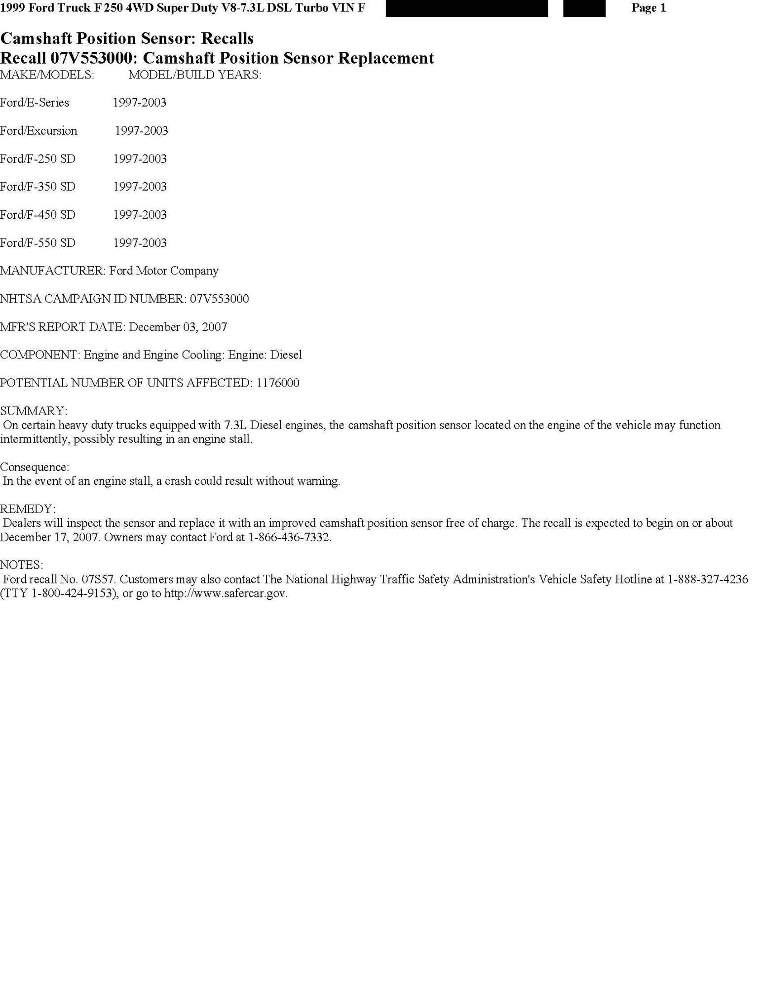

They were recalled for performance #07S57 in U.S. I can only assume the UK Followed

I've been doing a bit of searching & it seems that the original sensor doesn't always come out very easily, lots of stories about rounded bolt heads & broken sockets, but not any about broken bolts, then the original sensor doesn't pry out either, I'm going to speak with the service manager on Monday & find out what colour the new sensor is, then flip a coin to decide whether I let them change it or just take the new sensor & keep it & tools to change it with the truck.
