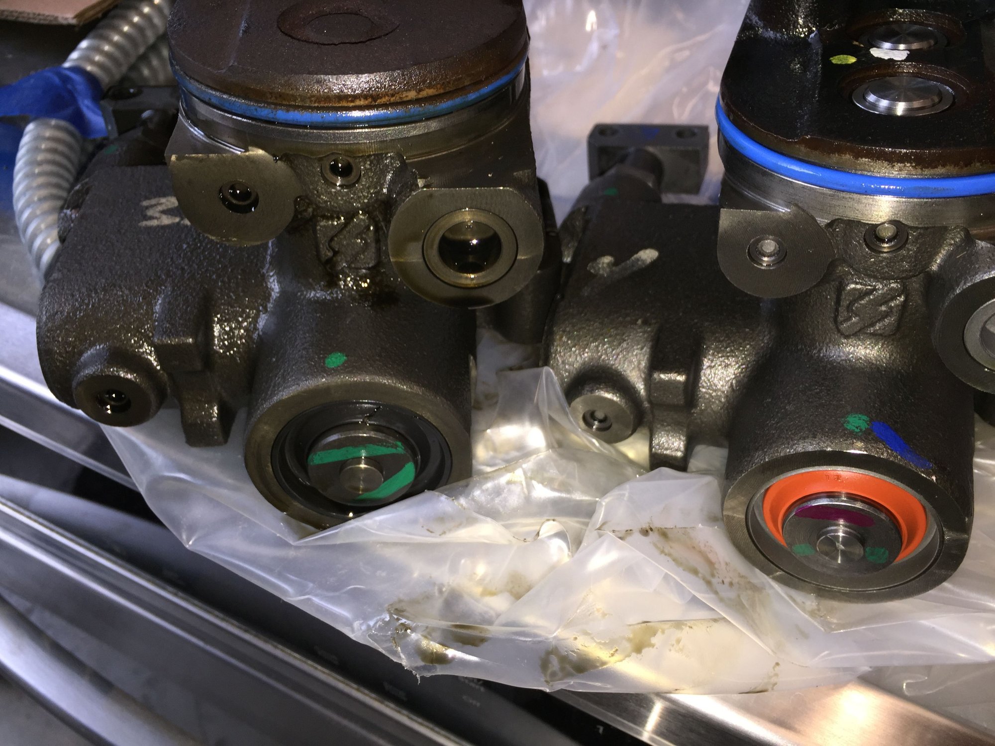

Old Jun 16, 2016 | 06:19 AM
truckrider814's Avatar
truckrider814
Joined: Dec 2008
Posts: 1,007
From: Sterling, Va
It was the hpop found a tear in the seal still ain't figured out why it didn't leak tested it hot cold an 7 ways from Sunday no leak. Threw a reman pump in and works like a charm.
