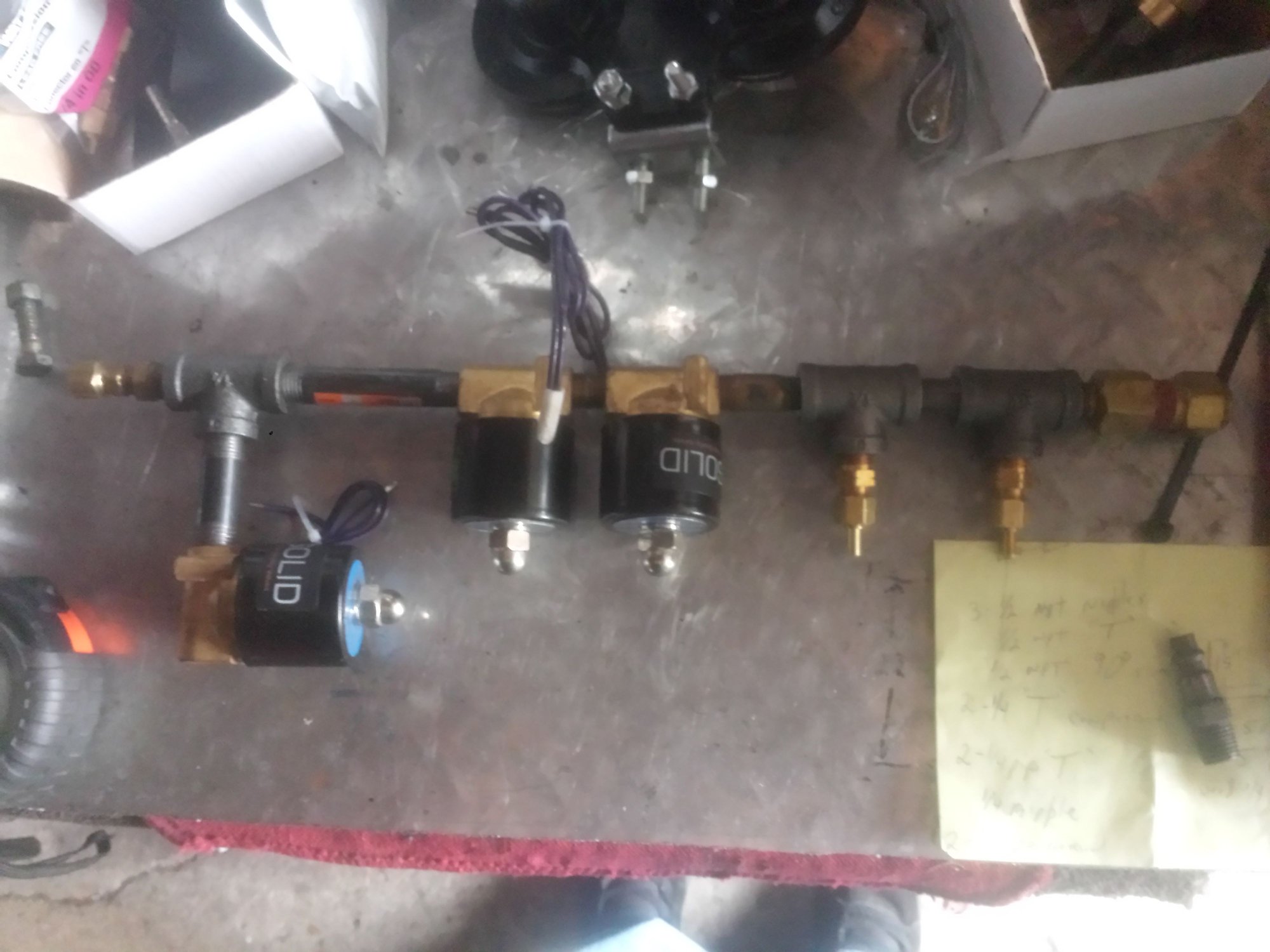

My whole system is comprised of parts I ordered from Amazon. The compressor is a Viair 2 gallon 150psi 30%DC VIAIR 150 PSI High-Flow Air Source.
The manifold I assembled with the valves are to fill or dump air for the airbags. I have a line that goes to a stake pocket in the body for a hidden air chuck to fill tires and such. Also I ran a line to the front for the triple air horns. The bags are adjustable on the fly using the switch I mounted in the dash, also from Amazon.
I used 5" wide 3/16 aluminum plate for a mount and hung it under the body on the passenger side. It's up out of the way and at eye level can't be seen.
Sorry for fuzzy pics, lens broke on my phone.

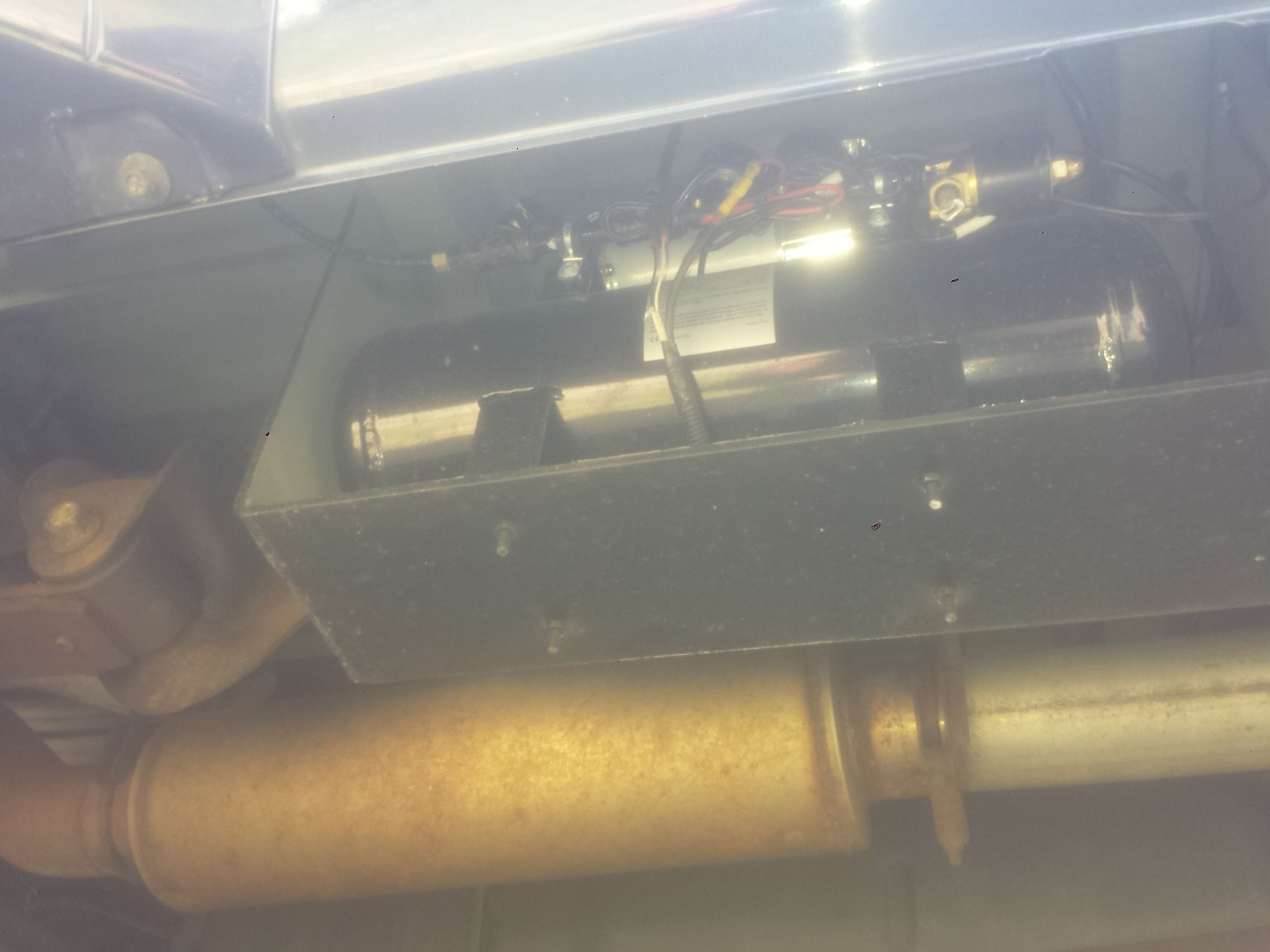

Here's my set up. Only thing I changed was I put a 7 gallon tank on since this picture. It's a viair system
