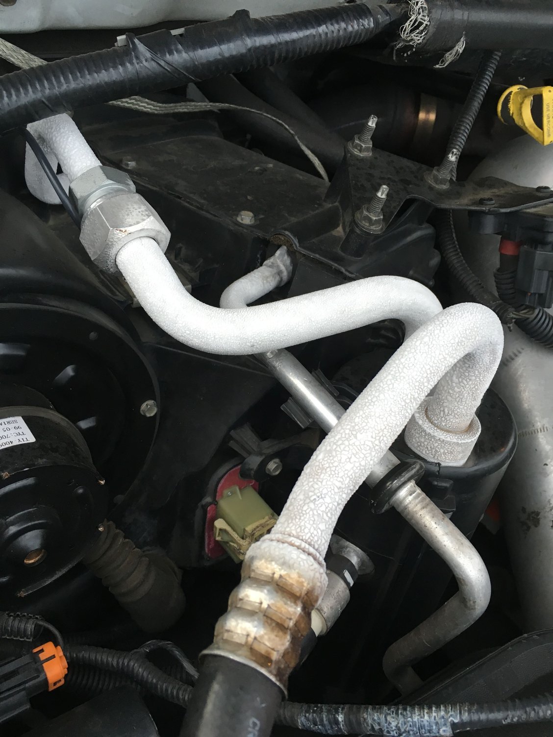

The orifice was easy to replace but you need to evac the system before opening. Then you need to bring the system to a deep vacuum for about half an hour then you can recharge but make sure you get the refrigerant volume correct. There is no need for anything other than the correct orifice in my opinion.
Here are the lines on my evaporator; frost was forming and the air stayed ice cold even at idle...
Shouldn't be ice on the suction line unless it is undercharged. Did the shop pull a vacuum b4 recharging ?

Moisture & non condensables (air) can also make it freeze up - If a proper vacuum is pulled b4 charging this should not be the case.
